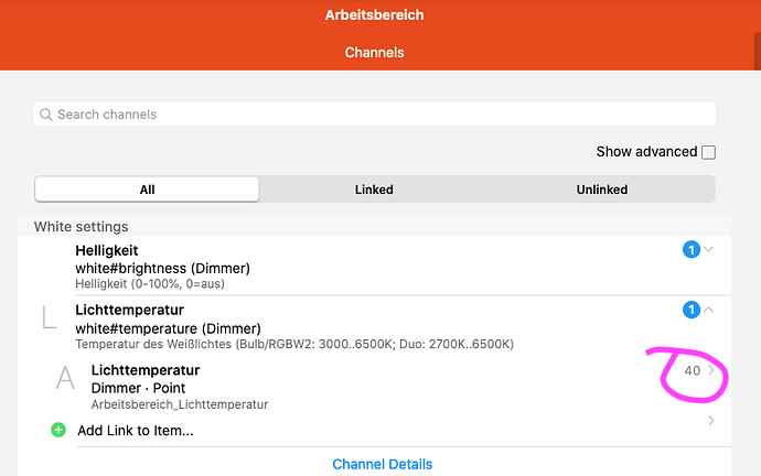

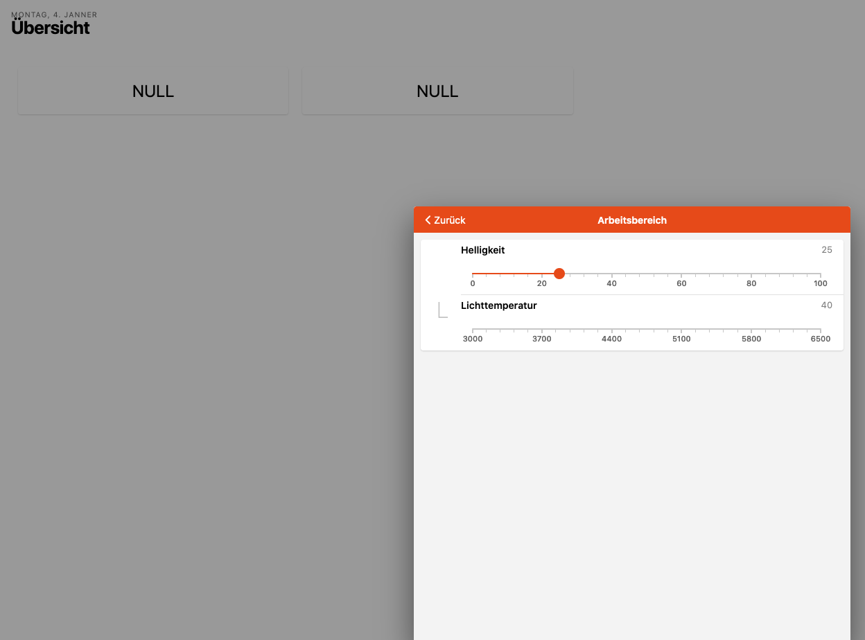

I have an issue with my shelly duo bulbs. When changing the color temperature via UI slider, nothing happens on the bulb, and I also don’t see anything happen in the events.log
Brightness works fine, it affects the bulb immediately, and it also shows in the events.log

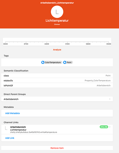

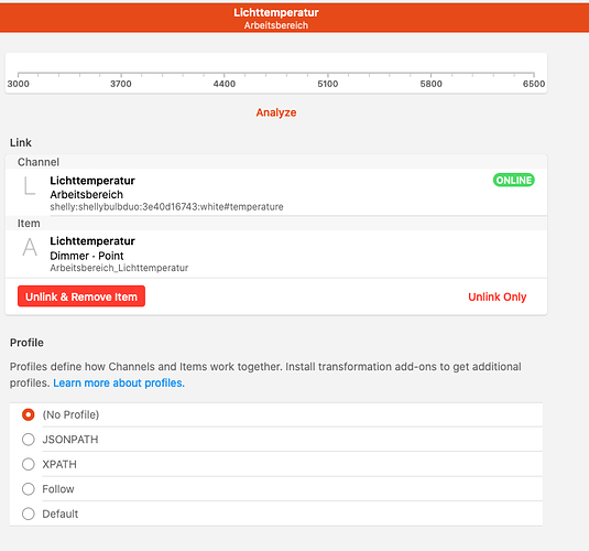

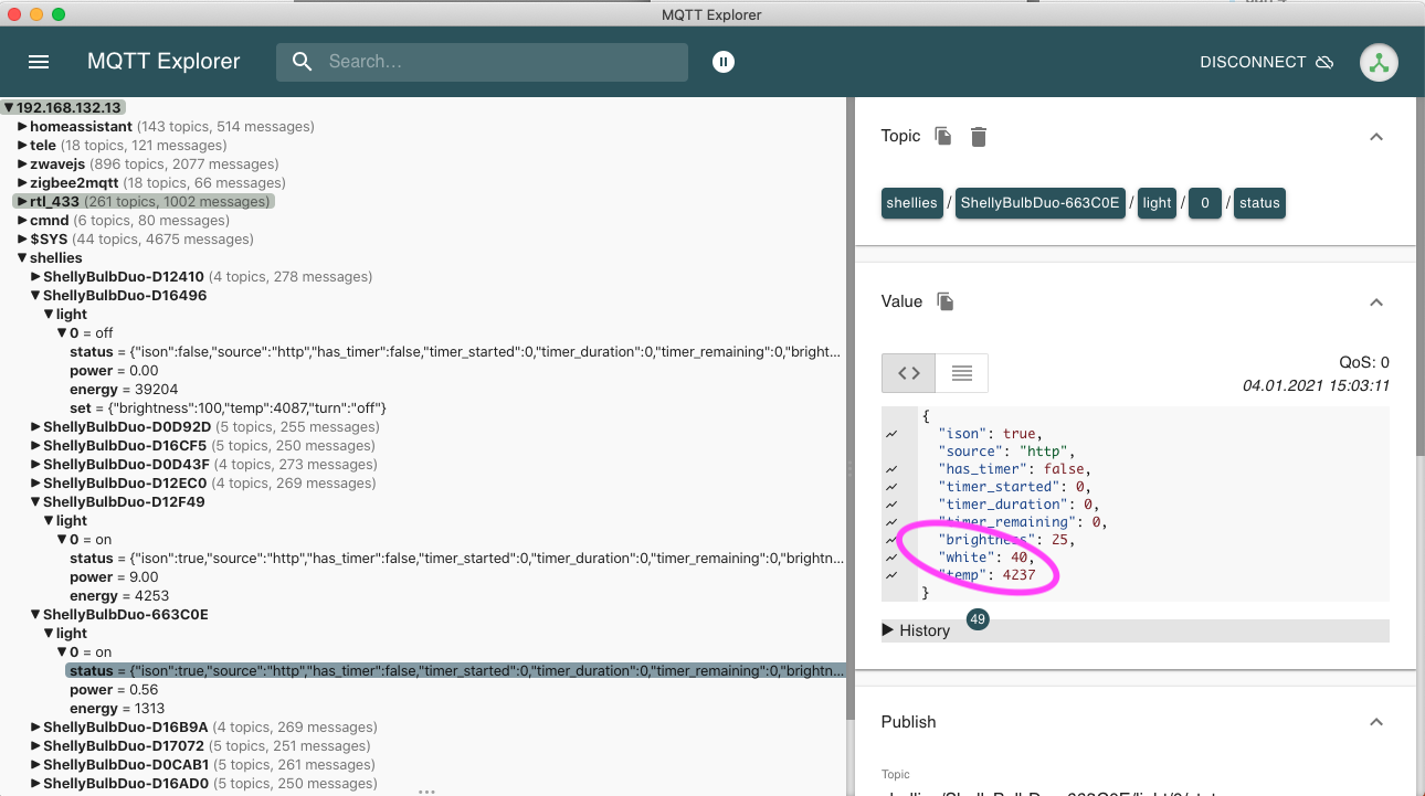

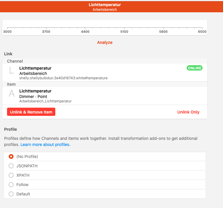

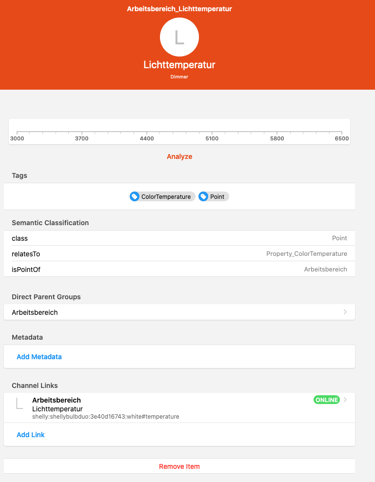

So I found out whats happening. the binding converts it to percent, but when you create an Item from the thing, the default widget has min=2700 and max=6500 set.
if you override the default widgets to use 0 and 100 it works as it should. Still I don’t think its nice to use percentage for color temperature…
