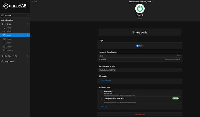

Hi ! Sorry ! its a string !
If i press short on the button → i see Short push
If i press long on the button → i see Long push
i see this in the item below the string → picture

in the log file i see if i press the button short
shelly:shellybutton1:2621ea90ab:status#button triggered SHORT_PRESSED
and under the shelly button thing i see this channel :
Button
status#button(Trigger)
but this channel is not linked and i cannot add this channel to model
so i thing the rule never could work
What is the problem here ? How can i add this channel to model ?

rlkoshak
(Rich Koshak)
January 2, 2022, 2:37pm
#13
You can’t. That is an Event Trigger Channel. You trigger the ride using the Channel directly, not through an Item.
Don’t get to focused on the Model. That’s just a little bit if organization on to of the stuff that really matters, Things and Items.
