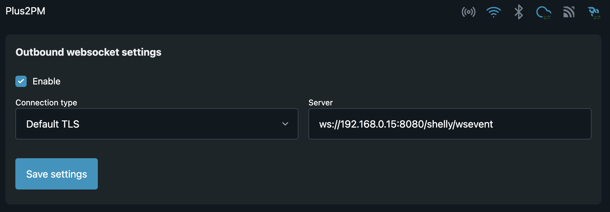

It definitely only works with outbound websockets enabled and configured. If I disable it in the Shelly I do not get any status updates. I am testing right now with a “Shelly Plus 2PM”
Here is my config in the Shelly; 192.168.0.15 is my OpenHab server.

So just to summarize how this worked for me:
Shelly (Gen 1)
Open Shelly config page in browser
→ Internet & Security → Advanced - Developer Settings
Enable CoIoT: Yes
CoIoT Peer: :5683
Shelly (Gen2,Gen3,Gen4,…)
→ Settings → Connectivity settings → Outbound websocket
Enable: Yes
Connection Type: Default TLS
Server: ws://:8080/shelly/wsevent
I did not change anything in the OpenHab Shelly Binding Config, “Auto CoIoT” is still on in my case.
I have 18 Shellies and for 1-2 Shellies I still did not get any state updates, I had to remove the thing and add it manually again and then it worked.
