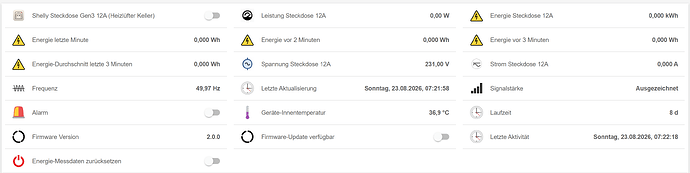

I have “Shelly Plug S Gen3” running, see my channels:
version: 1
things:
  shelly:shellyplusplug:eb3a3be559:
    label: Shelly Plug S Gen3 (Heizlüfter Keller)
      deviceIp: 192.168.1.183
      updateInterval: 60
      enableBluGateway: false
      enableRangeExtender: false
    channels:
      device#alarm:
        type: alarmTrigger
      device#wifiSignal:
        type: signal-strength
      device#firmware:
        type: deviceFirmware
      device#internalTemp:
        type: indoor-temperature
      device#uptime:
        type: uptime
      device#heartBeat:
        type: heartBeat
      device#updateAvailable:
        type: updateAvailable
      relay#output:
        type: relayOutput
        label: Output
        description: Controls the relay output
      relay#timerActive:
        type: timerActive
      relay#autoOn:
        type: timerAutoOn
      relay#autoOff:
        type: timerAutoOff
      meter#currentWatts:
        type: meterWatts
        description: Aktueller Energieverbrauch in Watt
      meter#currentPower:
        type: currentPower
        label: Power Consumption
        description: Current power consumption in W
      meter#totalKWH:
        type: meterTotal
        description: Gesamtverbrauch in kWh seit das Gerät eingeschaltet wurde (wird je nach Modell beim Neustart zurückgesetzt)
      meter#totalEnergy:
        type: totalEnergy
        label: Total Energy Consumption
        description: Total energy consumption in kWh. Gen1 devices may reset on power cycle; Gen2+ devices persist across restarts.
      meter#voltage:
        type: meterVoltage
      meter#current:
        type: meterCurrent
      meter#frequency:
        type: meterFrequency
      meter#lastPower1:
        type: lastPower1
        label: Durchschnitt letzte Minute 1
        description: Der durchschnittliche Verbrauch innerhalb der letzten Minute
      meter#lastUpdate:
        type: lastUpdate
      meter#energyHistMin1:
        type: energyHistMin1
        label: Energy - Previous Minute 1
      meter#energyHistMin2:
        type: energyHistMin2
        label: Energy - 2 Minutes Ago 2
      meter#energyHistMin3:
        type: energyHistMin3
        label: Energy - 3 Minutes Ago 3
      meter#energyAvgLast3Min:
        type: energyAvgLast3Min
      meter#resetTotals:
        type: meterResetTotals
Note that there are still channels to be deprecated in the future like e.g. “meter#currentWatts” or “meter#totalKWH”. If you have items linked to these, i would unlink them and relink to the appropriate new channels.
