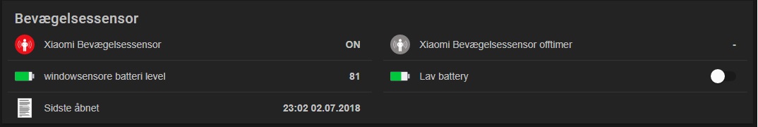

My goal was to resolve when a PIR registered latest motion detected in a timestamp I could show in a sitemap.
Like this:
The label âsidst ĂĽbnetâ and then time, is when this PIR last went on. (ie latest motion detected).
The difference however, this example is the xiami motion sensor, which has a channel for latest motion detected.
All my other PIR´s I´ve got doesn´t have this channel.
So I thought (expected I guess) I could âbuildâ a timestamp from a rule using the build-in (now) time, and just show this time (latest motion detected) in sitemap. Just like the Xiaomi sensor.
In fact, I would expect this to work with all kinds of items which change state. I also thought this would be a peace of cake rule. Guess I was wrong.
