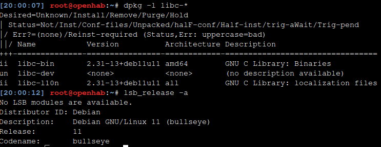

I tested the new version but it didn’t work on my system.
The signal “add-on” gave me following error on the things-page:
**HANDLER_INITIALIZING_ERROR**
/var/lib/openhab/tmp/libsignal2713855046520776408/libsignal_jni_amd64.so: /lib/x86_64-linux-gnu/libc.so.6: version `GLIBC_2.33' not found (required by /var/lib/openhab/tmp/libsignal2713855046520776408/libsignal_jni_amd64.so)
The system I have is a debian 11 “bullseye”, which support ended. Beacuse of this I can’t update to “libc” > 2.31
So I have to update to Debian 12 first, I think.
Am I correct?
Greetings
To save (my) time, I don’t compile the libraries that I include in the release. I use those from exquo, listed here.
(By the way, the listing seems to not be up to date, because it says glibc v2.28 despite not working on your 2.31 system)
Other library releases from the other listed repositories should, maybe, have different requirement and could work. Theorically, it just means replacing the lib in the .kar file by another one to test, but right now every time I tried to do some tinkering like that, it ended badly (don’t know why, but I never managed to install a working .kar without using the marketplace as an intermediary).
So, building/testing consumes time and I honestly prefer not to risk downgrading version.
Unless you have another compatibility issue preventing from doing so, upgrading to debian 12 is probably for the best.
I use a debian 12 system myself.
