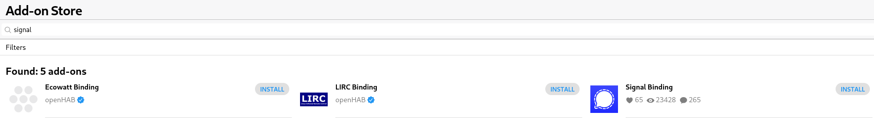

Hi, I just upgraded to OH 5.0.3, and there’s no Signal add-on displayed in the store anymore. Is there some version number which needs to be bumped up to match?
Thanks :slight_smile:
Strange, I upgraded to 5.0.3 too and I can see it in the store:
I installed it and it works as usual.
Probably a cache issue or something. Clearing cache or restarting may do the trick?
