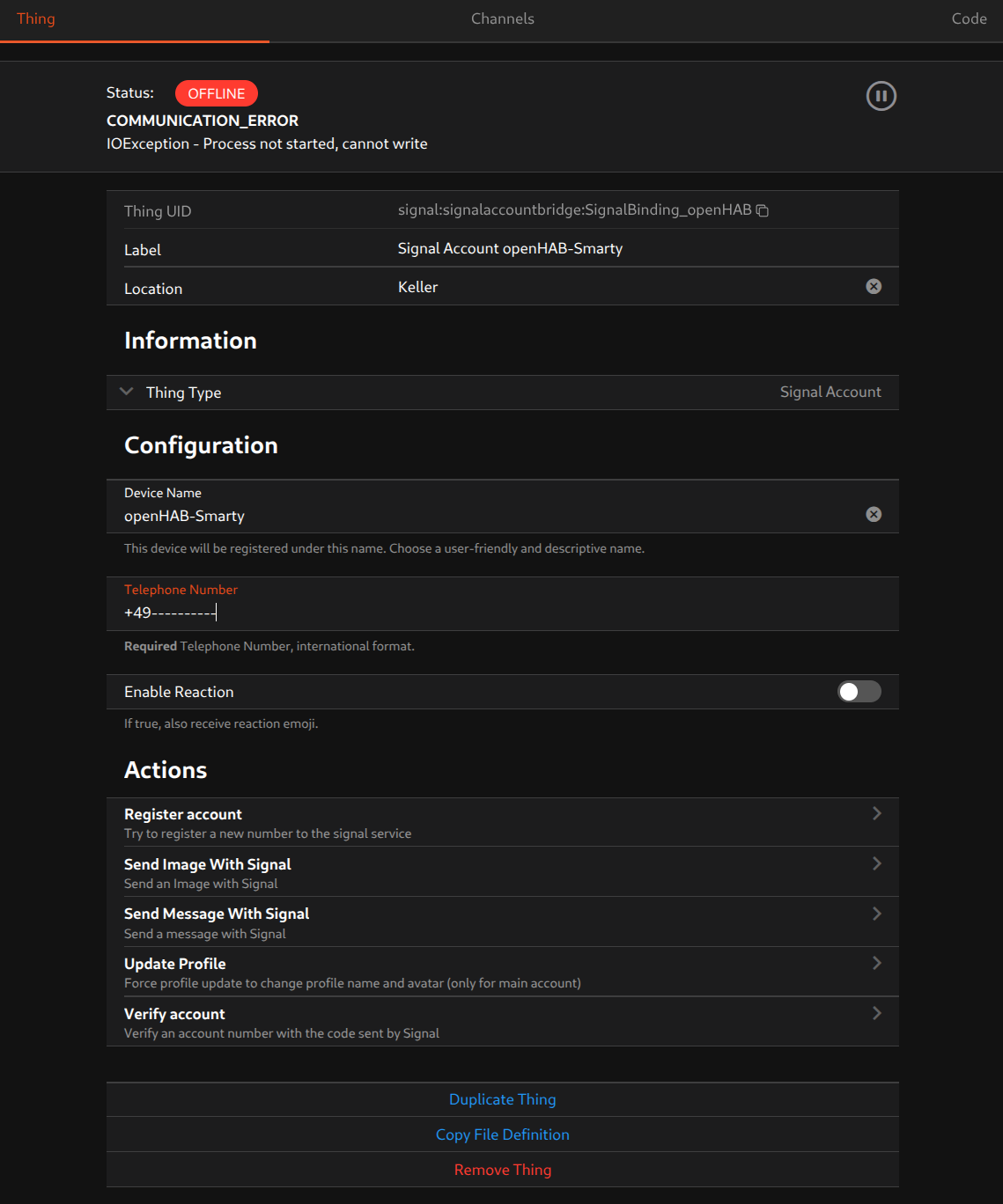

Since the last OpenHab Update the Signal Binding doesn’t anymore. There are 2 red entries in the log-viewer:
  1. error message
09:33:32.085
Timestamp
Apr 23, 2026, 9:33:32 AM
Level
ERROR
Logger Class
org.openhab.binding.signal.internal.protocol.service.JsonRpcAbstractSignalService
Message
Fatal exception inside the signal receiving thread for. Will not try to start again,unless manually restarted.
Stack Trace
org.openhab.binding.signal.internal.protocol.service.UnrecoverableException: Cannot start process
at org.openhab.binding.signal.internal.protocol.service.JsonRpcStdioAbstractService.internalStart(JsonRpcStdioAbstractService.java:80)
at org.openhab.binding.signal.internal.protocol.service.JsonRpcAbstractSignalService$ReceivingThread.run(JsonRpcAbstractSignalService.java:215)
Caused by: java.io.IOException: Cannot run program "/var/lib/openhab": Exec failed, error: 13 (Keine Berechtigung)
at java.base/java.lang.ProcessBuilder.start(Unknown Source)
at org.openhab.binding.signal.internal.protocol.service.JsonRpcStdioAbstractService.internalStart(JsonRpcStdioAbstractService.java:78)
... 1 more
Caused by: java.io.IOException: Exec failed, error: 13 (Keine Berechtigung)
at java.base/java.lang.ProcessImpl.forkAndExec(Native Method)
at java.base/java.lang.ProcessImpl.<init>(Unknown Source)
at java.base/java.lang.ProcessImpl.start(Unknown Source)
... 4 more
“Cannot run program “/var/lib/openhab”: Exec failed, error: 13 (Keine Berechtigung)” → /var/lib/openhab is a folder and no program. What are the expected access rights?

“java.io.IOException: Process not started, cannot write” → Where to write?
(What are useless error message. At least for me.)
The cause of the 2nd error is probably the 1st error and therefore a “simple” access rights issue.
Can someone post the correct access rights?

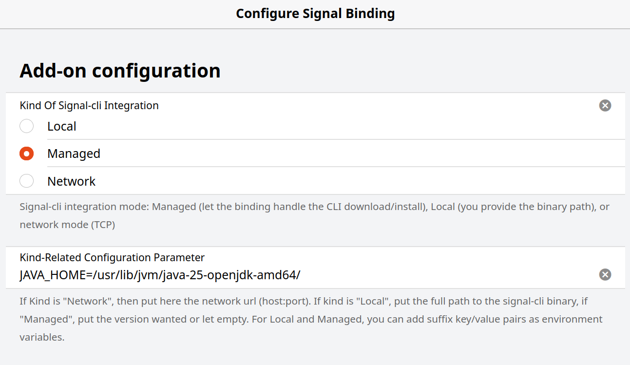

You configure this behavior at the binding level. Look at the documentation.
BUT, bad news, the managed version, unfortunately, is not completely autonomous. There is a caveat, as signal-cli 14+ works with Java25+ only. You have to provide the binding a path to the JDK25+ home. To do so, write, in the “configuration” parameter, the following :
JAVA_HOME=/your_path/to/the/jdk25/
(of course, adjust it to a valid path)

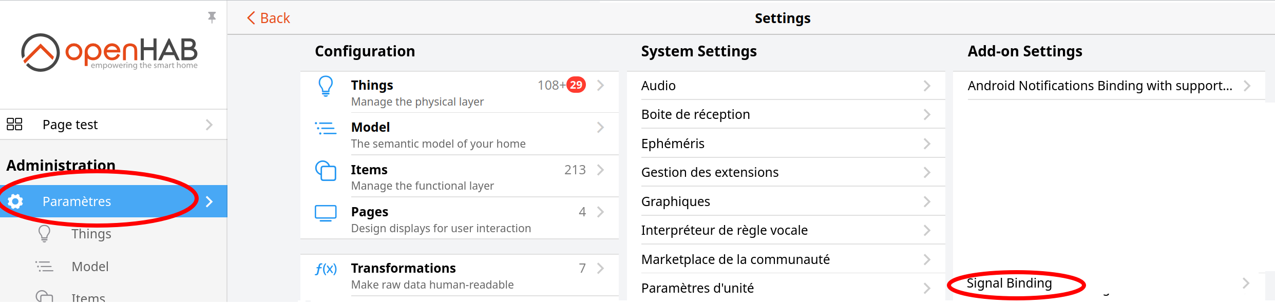

My thing config page looks like this. I don’t find anything you mentioned. Where can i find the mentioned “setting page”?
It this link, right? openhab-addons/bundles/org.openhab.binding.signal at 5.0.0-signal-ALPHA15 · dalgwen/openhab-addons · GitHub
There are no Install-Instructions you mentioned or did i simply not found them?
No, this is “binding-level” settings, not “thing-level” settings.
(sorry, french UI here. “Paramètres” = settings):
(great paint skills, isn’t it ? :smiling_face_with_sunglasses: :rofl: )
I don’t remember mentioning “install” instructions ? Anyway, yes, the link is the right one.

I was recently there, but it’s empty:
Do you know why?
I removed the signal binding and installed it again. Now it looks like your screenshot and the parameters are there.
Dear dalgwen
i was able to get this update working on a raspberrypi 4 with openHAB 5.1.4. Thank you very much for this. It simplifies my life and reminds us again on the open windows and the finished washing machine.

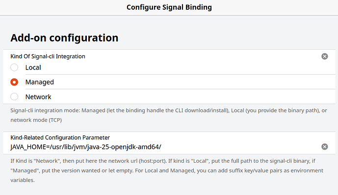

I tried “local” and “Managed”. With local i was not succesful. I was able to install signal-cli, register and send messages. But with this approach i had a new local registration and not the one from openHAB.
I switched to “Managed” and this worked. Hint: only unzip the package. If you install it, the path switches to JDK25 and openHAB does not work anymore.
wget https://github.com/adoptium/temurin25-binaries/releases/download/jdk-25.0.2%2B10/OpenJDK25U-jdk_aarch64_linux_hotspot_25.0.2_10.tar.gz
sudo tar -xzf OpenJDK25*.tar.gz -C /opt/jdk25 --strip-components=1
/opt/jdk25/bin/java -version
sudo update-alternatives --install /usr/bin/java java /opt/jdk25/bin/java 25
sudo update-alternatives --install /usr/bin/javac javac /opt/jdk25/bin/javac 25
sudo update-alternatives --config java
sudo update-alternatives --config javac

I configured the JAVA25 within the signal-cli Startup-Script.
How can I configure it using the “environment”-Configuration? What is the separator between JAVA_HOME=/xxx/yyy and /full/path/to/Signal-CLI ?
Having to manage a separate java version is a burden I wish to alleviate. I hope to make use of the native GraalVM version (I managed to auto-build an arm64 version but windows and macos version will not be as easy). Again, if a knowledgeable people is reading this, your help is welcome :wink:
Strange ! But thanks for the report. If you ever want to receive messages, feel free to give me debug/log messages.
Wow, I actually reproduce this. But I think it’s not related to the signal binding. All the marketplace addon I installed have this issue. (honestly, it’s kind of a relief, not my fault :rofl: )
Oops, I didn’t test it. Thanks, I will look into it.
The separator is a space (AFAIK, it mimics the usual way to add environment variable when launching something from CLI). But if you ask, then it means that I should add it to the documentation.
