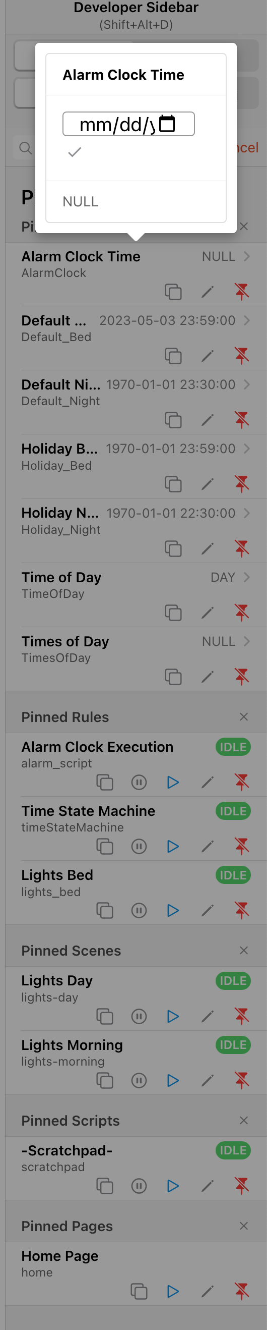

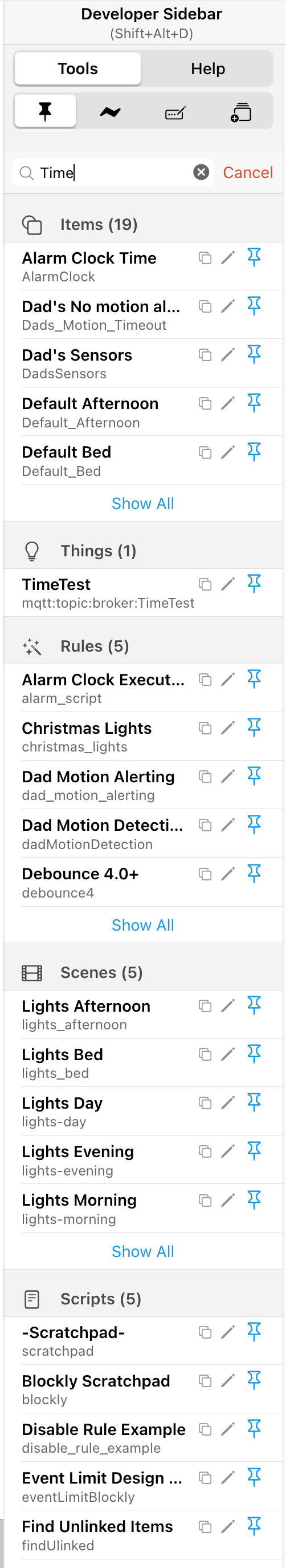

In the UI, definitely use tags and the developer sidebar (alt-shift-d) to find and pin all the stuff you are working on at any given moment. What I like about the developer sidebar is you essentially get to set up an adhoc organization for exaclty what you are working on at any give time. And this includes Items, Things, Pages, etc, not just rules.
For example, if I wanted to work on my time based rules I just search for “time” and pin the stuff I need.

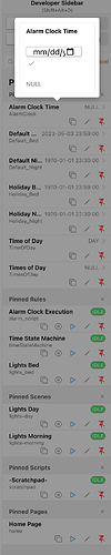

Clicking the pencil icon navigates striaght to the entity. Once pinned, Items can be controlled, rules run, enabled, disabled, etc all from the sidebar.
