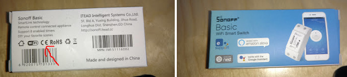

Yes, I know that some of their devices have CE certification. As I was
talking about my devices, which are all Sonoff basics, these don’t have CE.
I didn’t mean to generalize.
Regards
Interestingly, the certificate does not mention the Basics but I have a Basic in a box right here on my desk with the CE logo.
Shenanigans?
Probably…
Better check with Itead directly. They may have updated the basic and/or
obtained a CE for it.
I would check with them with the serial number. They are very helpful.
Regards
