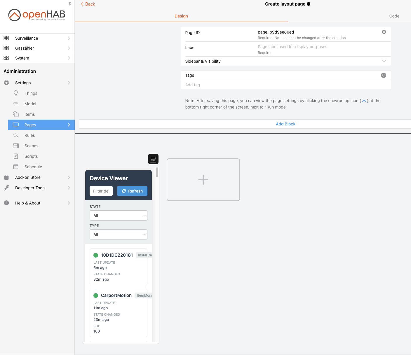

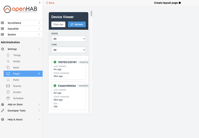

I have a simple question regarding a page in MainUI. I would like to have a page that only consists of an oh-webframe showing another website. So far I have only managed to have a rather narrow frame. I have tried with oh-webframe-card and oh-webframe and different combinations of Masonry and block.
Any hints or help appreciated how to get the webframe consuming all available width.
