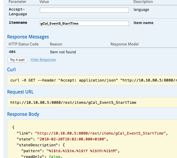

One error seems to be the Python script.
My Max Value is on 5 events!
if I now create an event at 17:00 for 17:15 and read in Openhab.
If I delete the event before 17:15 and read in Openhab, but only 4 events in the future, then the event will not be removed at 17:15 in Openhab!
I think we need a little Function like
if RetrievedEvents < MaxEvents than Clear all Openhab Item’s
I you didn’t Change the Script, in line 54 to 70 all events are purged and then they’re created anew… There shouldn’t be the fitfth element still in openHAB?
Yes … but if RetrievedEvents only 4 Item’s then the Fifth Item are not cleared
Ah - That’s right! I changed the script a bit, I’m running a few tests this week.
remember me to publish my code on the weekend. I took care of purging Event-IDs, which are no more used …

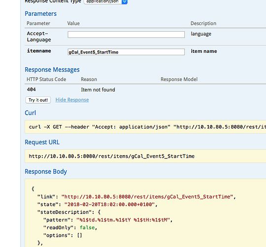

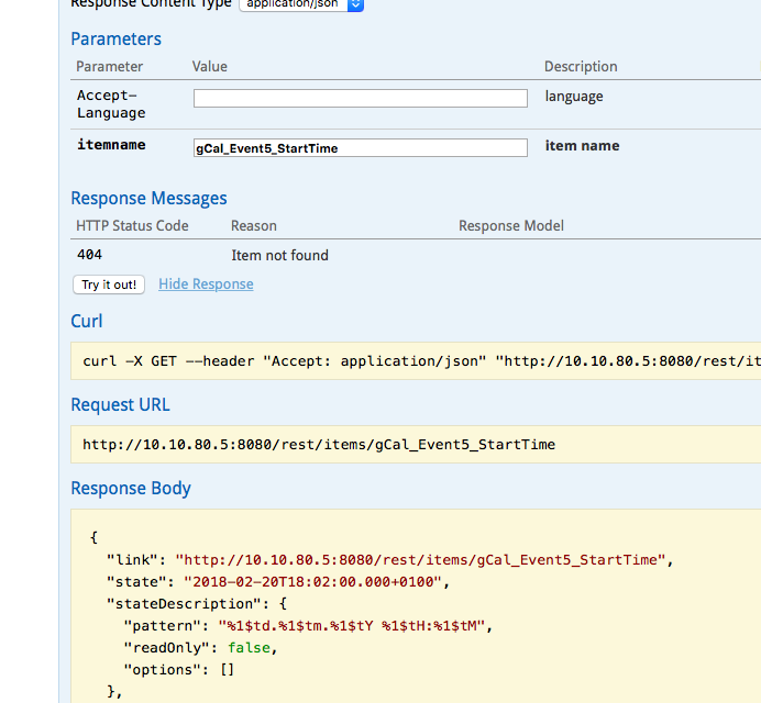

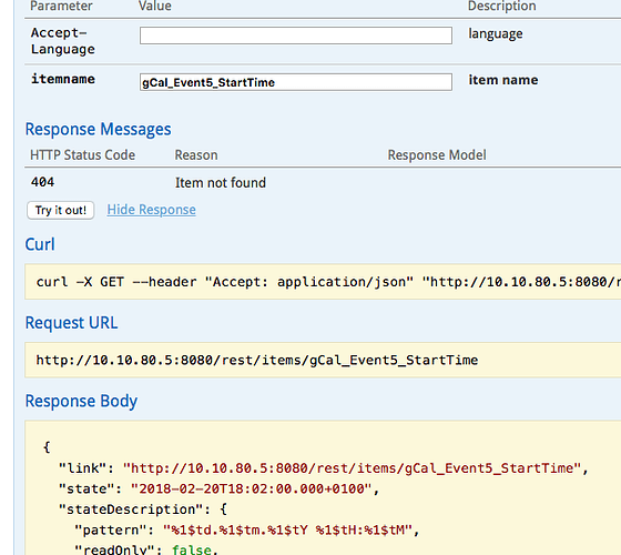

5 Events in Future
04
RestAPI 5 Event
Now I deleted the 5 Event…
RestAPI for 5 Event
