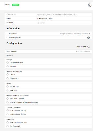

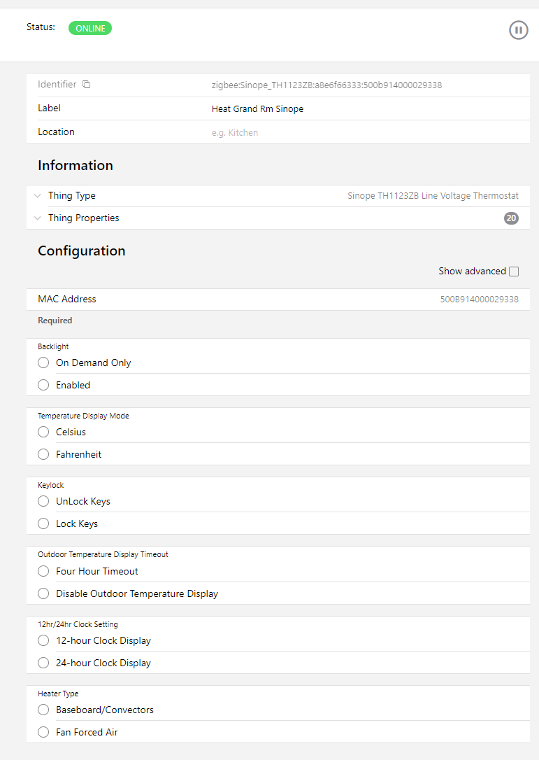

The configuration options appear but do not work. Screenshot and error log below.
18:20:01.724 [WARN ] [ee.internal.ZigBeeDeviceConfigHandler] - Config attribute_01_0204_1_18 has insufficient parts
18:20:01.724 [WARN ] [ee.internal.ZigBeeDeviceConfigHandler] - Config attribute_01_0201_1026_30 has insufficient parts
18:20:01.725 [WARN ] [ee.internal.ZigBeeDeviceConfigHandler] - Config attribute_01_0201_0401_33 has insufficient parts
18:20:01.726 [DEBUG] [ee.internal.ZigBeeDeviceConfigHandler] - Configuration update: Ignored zigbee_macaddress as no change
18:20:01.727 [WARN ] [ee.internal.ZigBeeDeviceConfigHandler] - Config attribute_01_0204_0000_18 has insufficient parts
18:20:01.728 [WARN ] [ee.internal.ZigBeeDeviceConfigHandler] - Config attribute_01_FF01_0017_21 has insufficient parts
18:20:01.728 [WARN ] [ee.internal.ZigBeeDeviceConfigHandler] - Config attribute_01_FF01_0276_30 has insufficient parts
