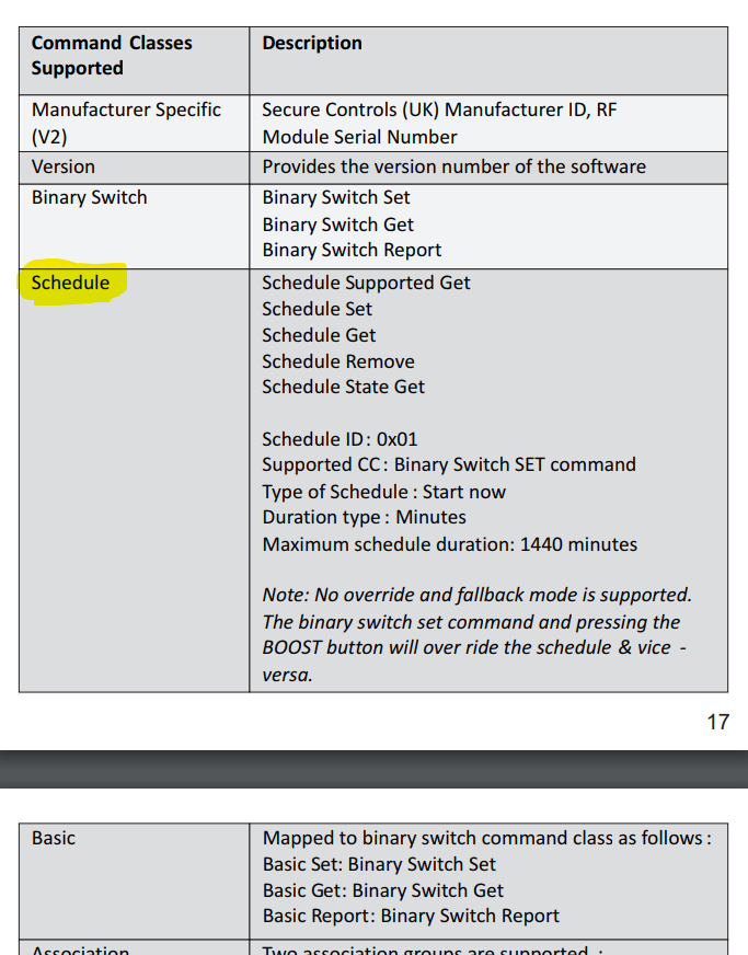

SIR-321 Missing Command and Events
The schedule command class is not implemented and would be a lot of work to implement - partly because the CC itself is quite complex, but also you’d need to work out how to shoe-horn its configuration into the OH UIs which are not really well aligned. This is really the biggest problem in my mind…
