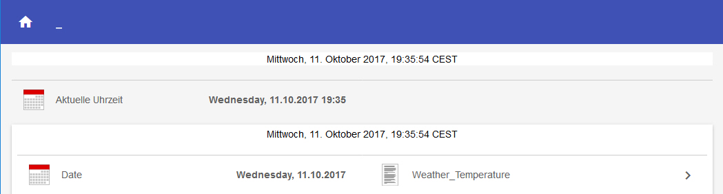

What error do you get und what do you mean with looks bad? First I have had problems with the quote signs in your example.
My test works well (2.2.0 Snapshot #1059)
sitemap _ label="_" {
Webview url="http://free.timeanddate.com/clock/i5takz9r/n309/tlde3/tt0/ta1"
Text item=CurrentDate label="Aktuelle Uhrzeit [%1$tA, %1$td.%1$tm.%1$tY %1$tH:%1$tM]"
Frame{
Text item=Weather_Temperature ...
So this has always been “wrong”. The only thing that changed is that OH now reports it in the logs. It has always been marked as a problem in Designer back as far as OH 1.7. I don’t think there is any going back to “the old way” because the old way was never really supported in the first place.
The “correct” way would be to add the Item to the Frame:
