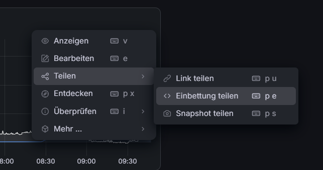

I use this embedding link for grafana panels in sitemaps:
Webview url="http://192.168.178.26:3003/d-solo/d92f64a0-d6ea-4520-9b04-6ce3c3afe3a0/wetter?orgId=1&panelId=5&tab=axes&from=now-250d" height=6
Please note .../d-solo/... instead of .../d/...
Thanks @nw378, the hint how to get the link with d-solo was very helpful. The height parameter seems to be mandatory.
