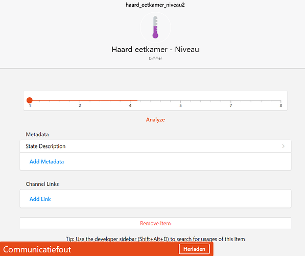

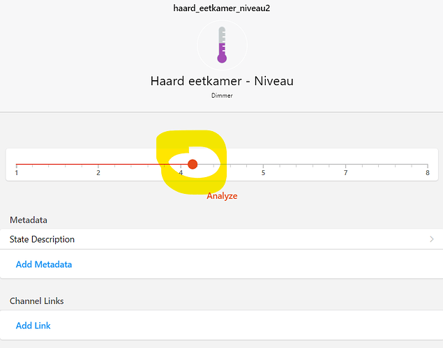

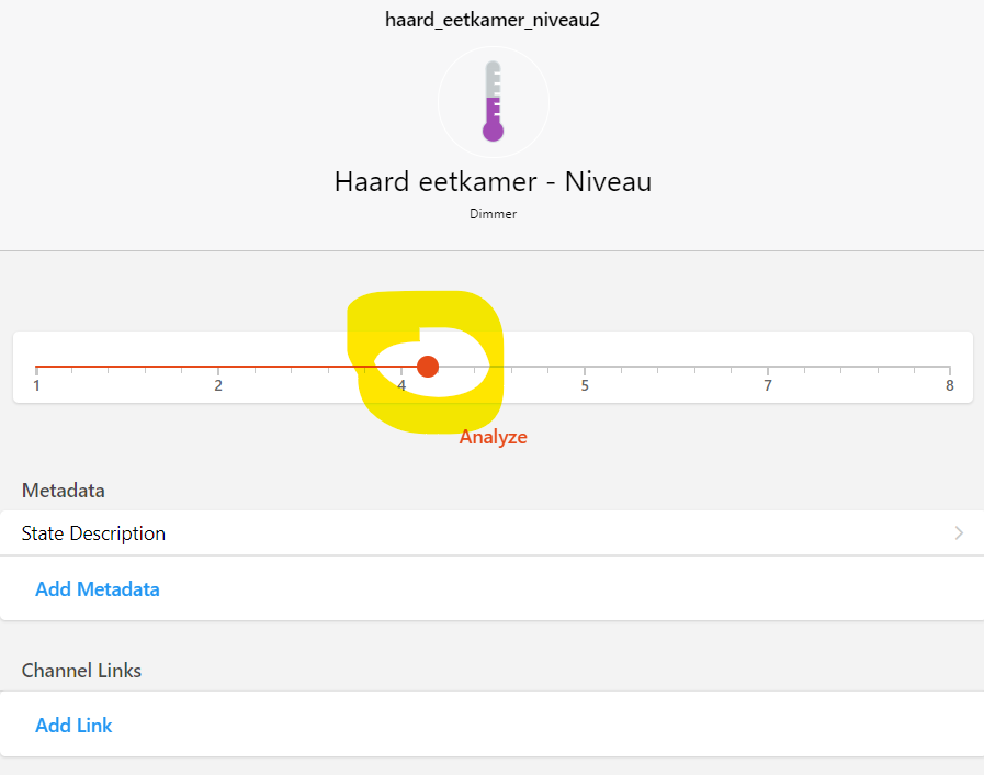

There’s something wrong with how sliders are visualised. I’ve set this item to 4, but as you see, the button is not exactly at 4:

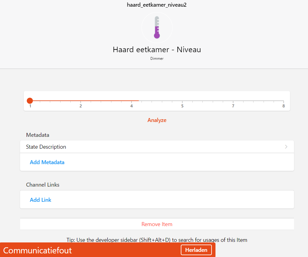

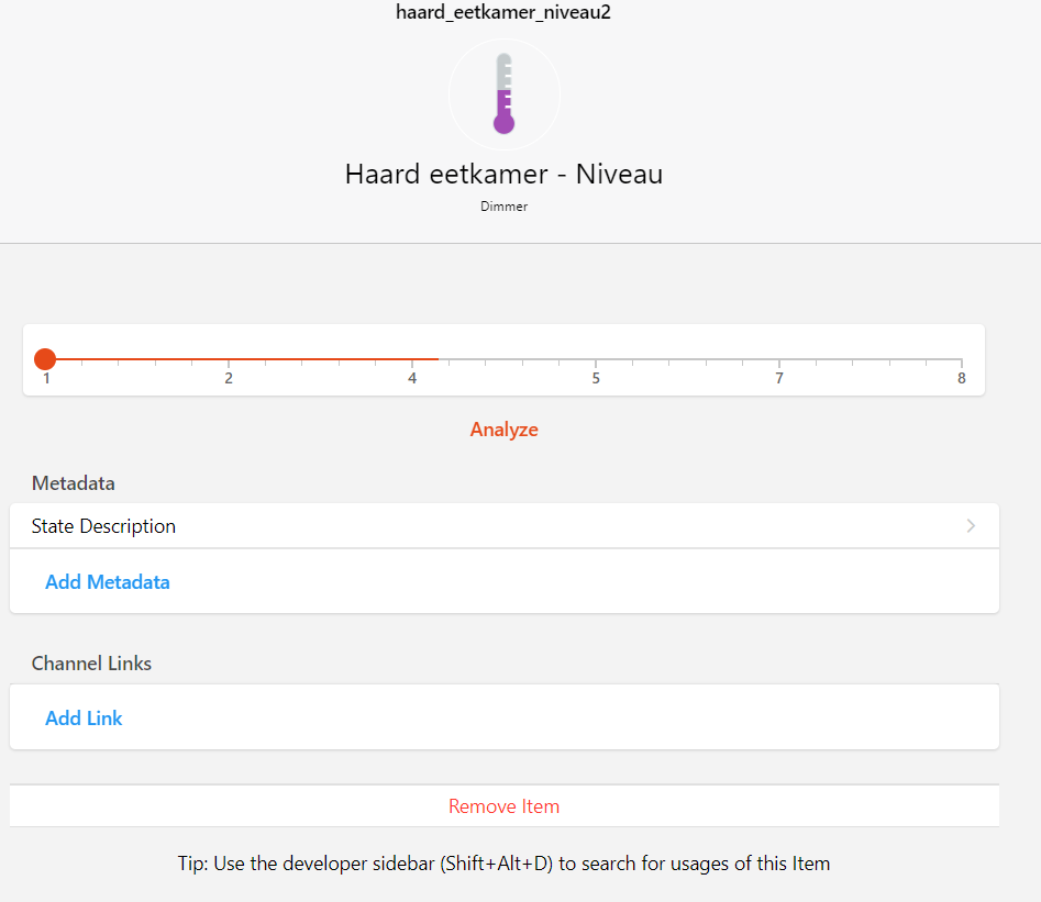

Also, if I refresh the page (F5), the communication between the browser and the item seems to break:
If I then try to change the dimmer to e.g. 5, I get this:
In the log, that triggers:
17:20:01.048 [INFO ] [openhab.event.ItemCommandEvent       ] - Item 'haard_eetkamer_niveau2' received command 4
So openHAB receives the already set command of 4, instead of my new command of 5.

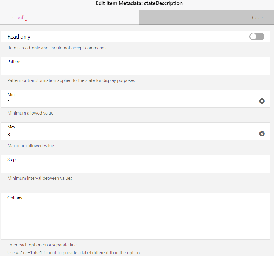

Also, the screen shot shows that you have State Description metadata for this item. What is that metadata?

This is the stateDescription:
(so basically: { stateDescription=" "[min="1", max="8"] })
Isn’t that part of the problem? :slight_smile:
I wonder if this is an error in handling the blank step setting in the state description. It should, default to one when there’s no value, but with the conversion to metadata and back again, sometimes there are string related errors. What happens if you explicitly set the step to 1 in the state description?
I tried that, following the same reasoning. No difference…

I think this is an unrelated problem. The fact that the slider dot is not in the right place is what I referred to earlier as one of the known set of slider issues. It has to do with when and how the f7 library calculates the functional of width of the slider and what might change after that calculation is done. This should have been fixed in all the MainUI versions of the slider. Your image looks like a sitemap. If that’s the case then you would want to file an issue in the UI repository but tag it with [BasinUI] so the maintainers know it’s a sitemap issue.
I’d add that the underlying capability of the device can be a factor. I have heat pump that only works in 0.5 degrees C. When I set the slider to 66 degrees F it settles to 66.2 because that is 19 C. I don’t know what 1 to 8 means in your case, but maybe if it is a stop on a thermostat, there might be a slight adjustment internal to the device to get to an allowable temperature
It’s an item without a link to a channel. So any number should be possible :wink:
