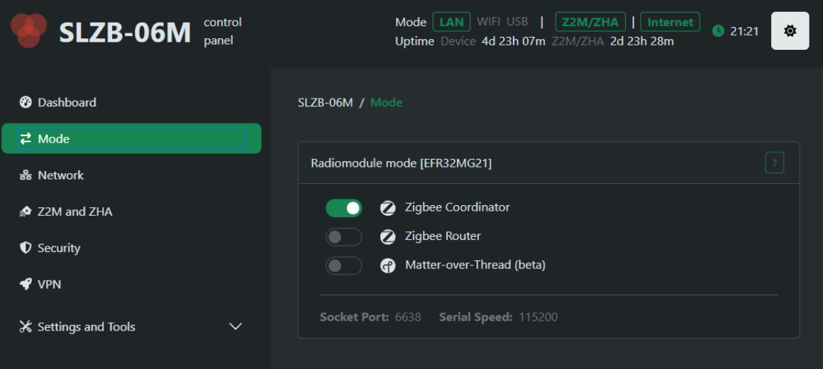

When you have the SLZB-06M connected, first try to access it via your internal network over the web browser. If that works, and hat I have done before auto discovery is to set the stick into ZigBee mode. It will automatically download the required drivers and install them on the stick. This will take 2-3 minutes and it will reboot automatically. After that you will see the zigbee coordinator mode being active.
then go to OH into things, hit the + at the bottom right, select the zigbee binding and hit “SCAN”.
The SLZB-06M will then appear below the scan button and you can activate it. After a shot time you will see 2ZM/ZAH going from white to green and you will be able to connect further zigbee devices.
