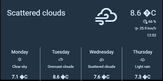

I’ve picked a bug.
How do I fix this?

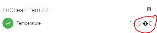

I’ve not set the ( °) at all. doing the same this all temp items.
Number:Temperature LocalWeatherAndForecastCurrentTemperature “Outdoor temperature” {channel=“openweathermap:weather-and-forecast:2fffbfbae:local:current#temperature”}
In this case the degree sign migth be missing on the system you are actually using to display PaperUI.
Checking on my system with a temperature item without label-defi option did show the sign correctly.
How do I fix that? Check through myopenhab and the same thing?

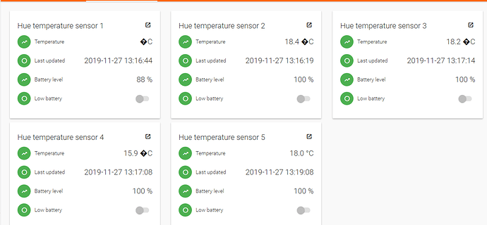

Yes. I’ve screen print a shot from my remote PC. Please see above. Thank for all your help!
PaperUI is for configuration but you should still see the correct info?? As @Thedannymullen mentioned what does it show in BasicUI or ClassicUI as this should be the place you control and view your devices.
Looking at this screenshot from PaperUI I see missing degree signs AND in one case there is a degree sign (sensor 5).
Did you by any chance force your web browser to use a specific character encoding? If so, that could explain why your browser can’t render the degree sign (°), if the character encoding reported by the web server doesn’t match the browser’s.

Thanks everyone. Still having the same issue. Check HABpanel and the same. Same even when logged in from remote PC -
