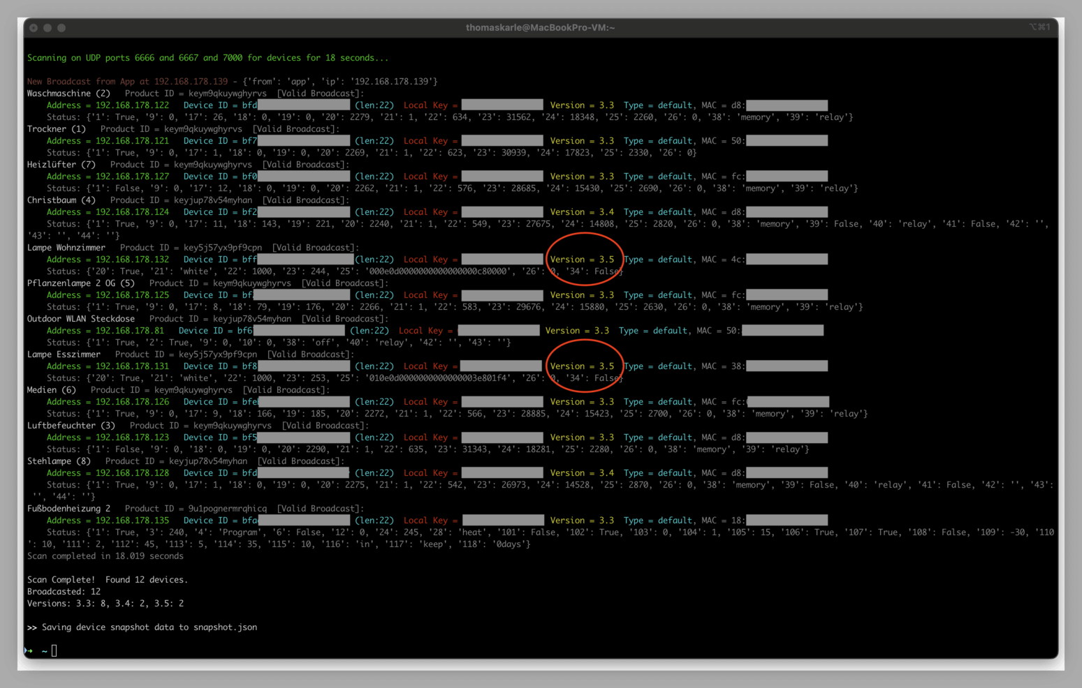

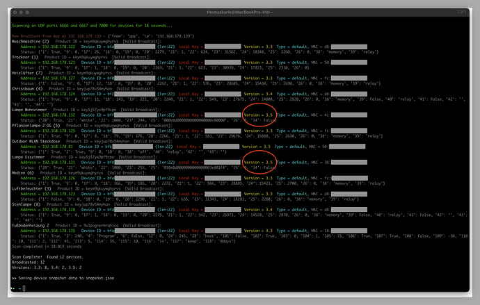

Hi everybody!
I have added a new TUYA device in OH and keep getting “Waiting for IP” etc.
After hours, when eval found out that my brand new device (lumiere Pendelleuchte) needs the protocol version 3.5
import tinytuya
# Tuya-Geraet konfigurieren
d = tinytuya.OutletDevice('bff1248b395386e28djyqw', '192.168.178.132', 'XF<`-=G7G_......')
d.set_version(3.5)  #
# Geraetestatus abrufen
data = d.status()
print('Device Status:', data)
I get the correct returns:
`Device Status: {'dps': {'20': True, '21': 'white', '22': 1000, '23': 200, '25': '0700000000000000000003e800c0', '26': 0, '34': False}`
all other versions 3.1, 3.3 & 3.4 give me the error feedback:
`Device Status: {'Error': 'Unexpected Payload from Device', 'Err': '904', 'Payload': None}`
After
If I add it manually in the OH THINGS UI in section CODE, I get the error in the UI:
`HANDLER_CONFIGURATION_PENDING {protocol=Der Wert 3.5 ist nicht in den erlaubten Optionen enthalten. Erlaubte Optionen sind: [ParameterOption [value="3.1", label="3.1"], ParameterOption [value="3.3", label="3.3"], ParameterOption [value="3.4", label="3.4"]]}`
Could you anyone add the NEW protocol version and its dependencies, please?
(Manual configuration is also not possible with this add-on, as the protocol vision is not supported.)
BTW:
According to my research, the protocol version has been available since at least the beginning of the year. The question is whether 3.6 is already available and can be implemented at the same time :wink: ?
All my devices of the last 3 years rely on API version 3.3 or higher. Here is an excerpt of my devices:
THX a lot
