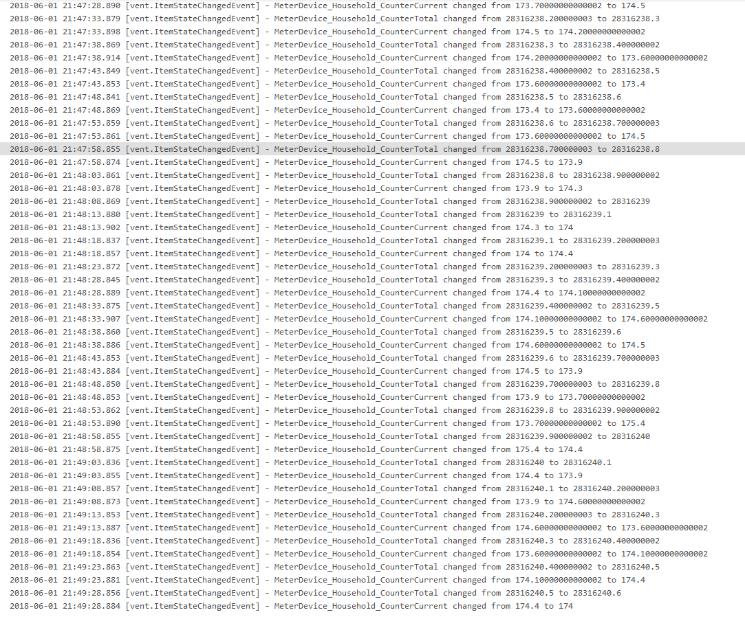

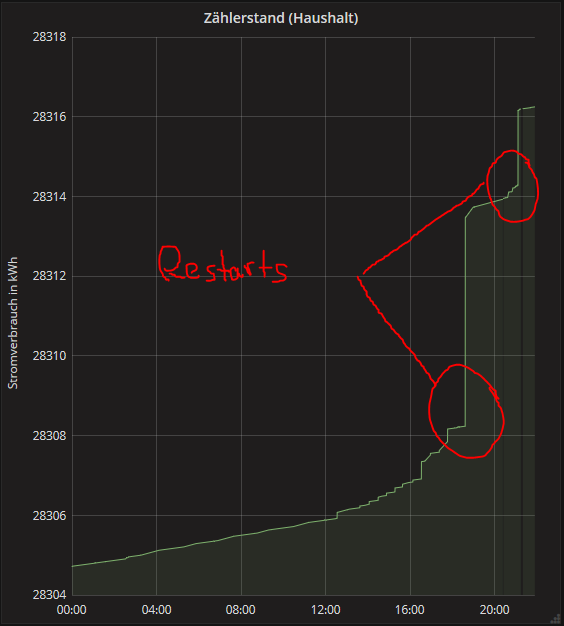

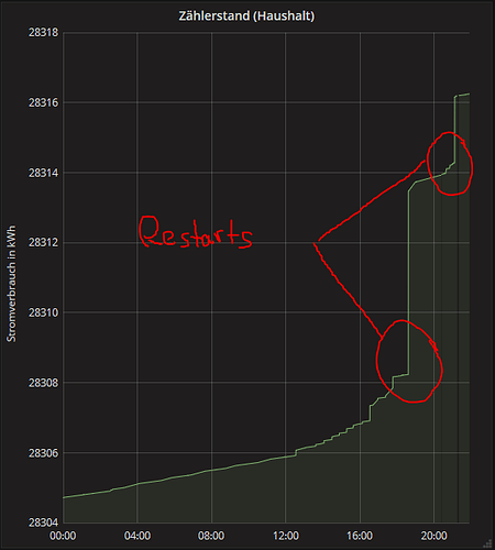

I thought it would work now and it looked like it, but the readings are not right. When starting the binding it’s reading the right values but from there on it’s only changing the read values by a few W even if I turn on a large consumer. When I restart the socat service to shut down the connection or restart the whole binding the real measurements are read again.
Trust me when I say the numbers are wrong. I know how much electricity all my devices draw, because I use your binding since a year now I believe. I will put some screenshots in this post.
I hope you can help me :slight_smile:
Keep in mind this next screenshot shows the total energy counter of my house.
