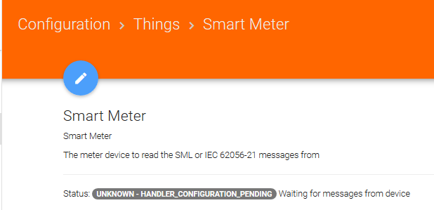

@msteigenberger first thanks for your continous support of the meterreader binding
While everything worked fine some time ago on an older OH version, I get an error on a newly test set up raspberry pi 3 with current OH 2.4 (testing build). The error is the same on my productive system.
2018-10-20 20:45:41.086 [me.event.ThingUpdatedEvent] - Thing 'meterreader:meter:0e7809a3' has been updated.
2018-10-20 20:45:41.127 [hingStatusInfoChangedEvent] - 'meterreader:meter:0e7809a3' changed from UNINITIALIZED (HANDLER_INITIALIZING_ERROR): org.eclipse.smarthome.core.thing.xml.internal.XmlChannelTypeProvider cannot be cast to org.openhab.binding.meterreader.internal.SmartMeterChannelTypeProvider to INITIALIZING
2018-10-20 20:45:41.165 [hingStatusInfoChangedEvent] - 'meterreader:meter:0e7809a3' changed from INITIALIZING to UNKNOWN (HANDLER_CONFIGURATION_PENDING): Waiting for messages from device

But on PaperUI side with fresh SML Binding install from https://marketplace.eclipse.org/content/meterreader-binding i got errors, it don`t work for me anymore.
It doesnt stop my Zwave Controller (Razberry2) like in my first install, but Smart Meter dont start working and said âUNINITIALIZED - HANDLER_INITIALIZING_ERROR org.eclipse.smarthome.io.transport.serial.SerialPort.setFlowControlMode(I)Vâ or
âStatus: OFFLINE - COMMUNICATION_ERROR Serial port /dev/ttyUSB0 is already in use.â

The status in the PaperUI ist still: Status: UNKNOWN - HANDLER_CONFIGURATION_PENDING Waiting for messages from device
