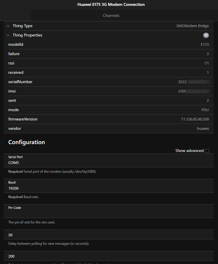

My binding settings:
2024-08-08_100635
I rebooted the computer twice and reconnected the USB device.

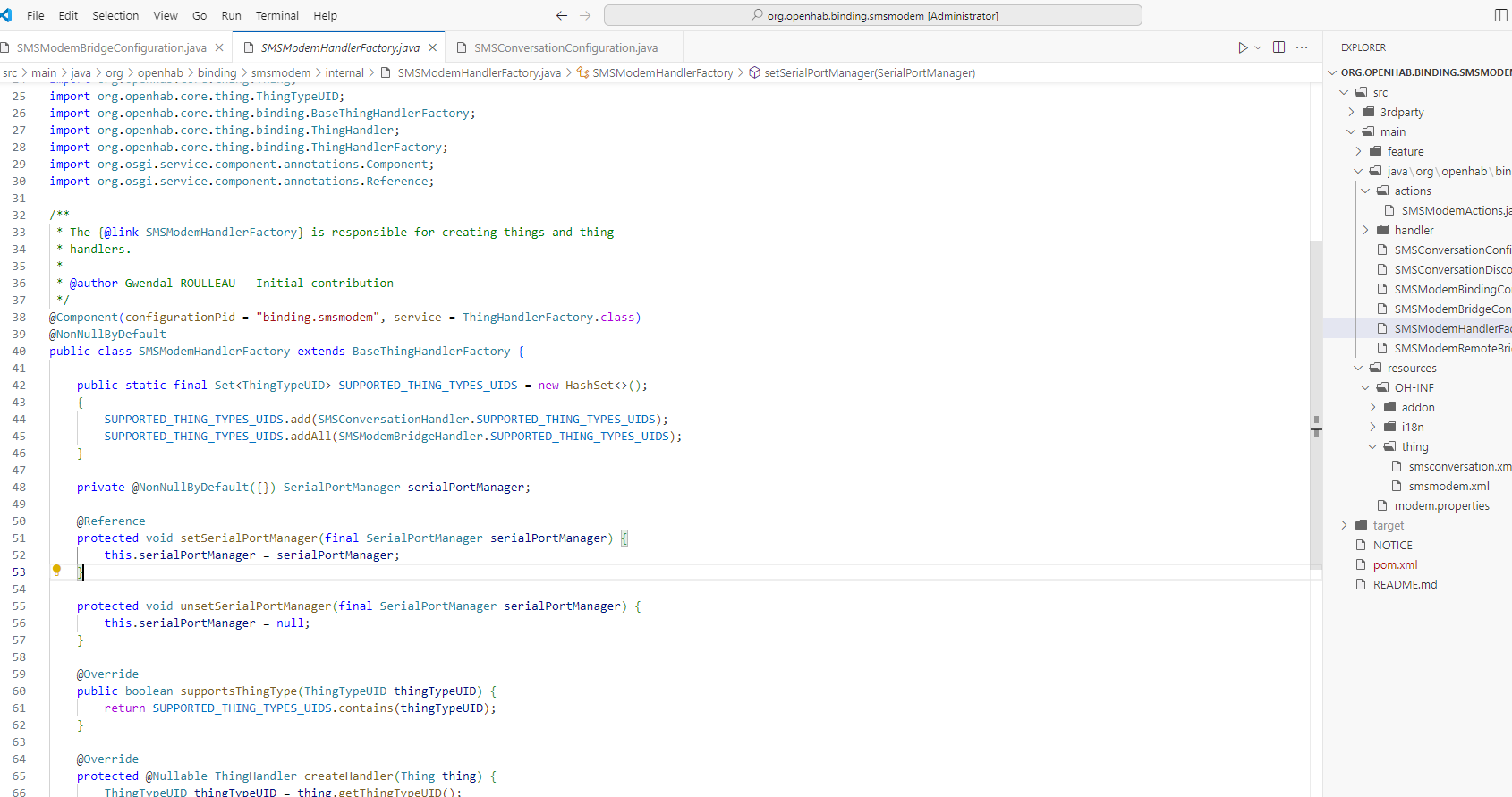

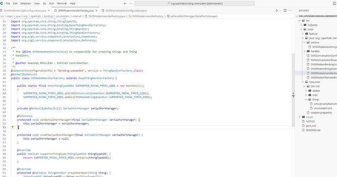

Next week I will find time and want to check the sending through debugging and inform you about the results.
The environment is ready but I’m busy with work
2024-08-12_104502
