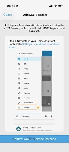

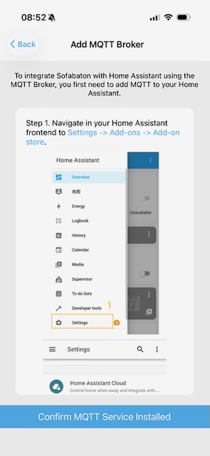

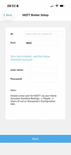

1) Setup the link to your MQTT broker in the Sofabaton App

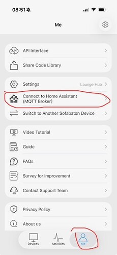

From the Sofabaton App, choose ‘Me’ in the bottom right, then ‘Connect to Home Assistant’
Confirm you’ve installed the MQTT server, just hit next on the confirmation page

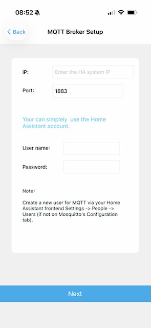

Enter the url and port of your MQTT server, username and password
You should get a confirmation screen saying it’s all setup.

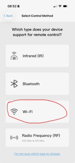

2) Setup a device on your Sofabaton remote
Still in the app, go to the devices screen and hit the + sign to add a new device. Choose ‘Wi-Fi’ control method.

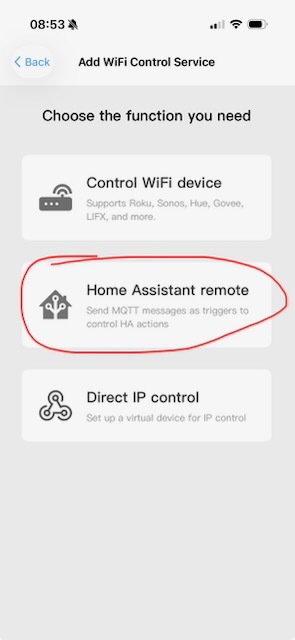

Then choose ‘Home Assistant Remote’

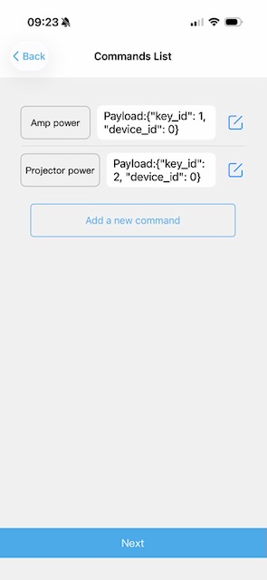

3) Add action buttons to your remote

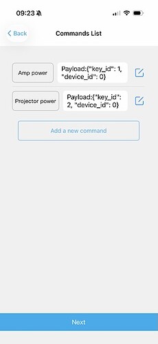

You now need to add action buttons that will appear on your remote.

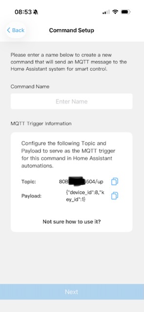

Note, that you can only modify the command name - ie, the name that appears on the button. Each button will be assigned a unique button number, there’s no way to change this - it’s allocated by the app.
You’ll see a ‘Topic’ and ‘Payload’ displayed under the command name. These are the important codes you need to copy and use in Openhab.
The topic will always be the same for your remote - this is it’s MAC address followed by /up
The payload is a combination of a device_id and key_id
The device is the device number in your list (ie, for me it was device number 8). The key number is the sequential number of the key. ie, the first button you add will be 1, then 2, 3, etc. As i say,there is no way to change this - you just have to remember which button number responds to your command name.
Hit next, you see the button commands you’ve setup. You can add as many as you like.

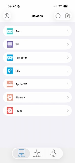

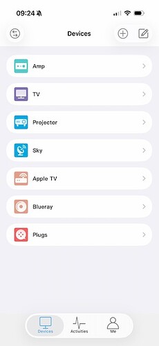

Once you’ve created you buttons, you’ll be asked to name the device and the app will download the settings to your remote.

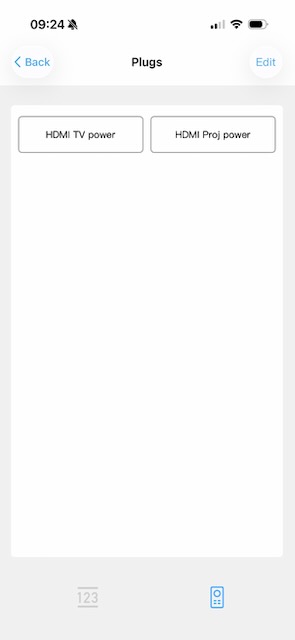

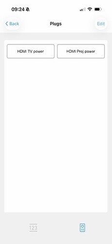

You’ll now see a new device. Here, I created one for all my Tapo plugs called ‘Plugs’:
When i click it, I see the command buttons I’ve setup:
These are also displayed on the screen on the Sofabaton X2.

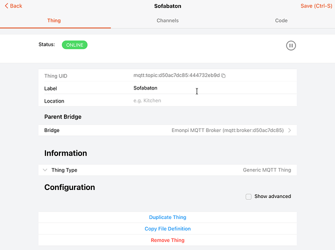

4) Create a Generic MQTT Thing to receive your Sofabaton messages
You need to create a Generic MQTT Thing that receives the MQTT message from the Sofabaton remote (I’m assuming here you’ve already setup your MQTT bridge in Openhab - if not, there’s a lot of posts on how to do that).
Create a new Thing by selecting the MQTT binding and then ‘Generic MQTT Thing’ as the Thing type.
Make sure you select your MQTT bridge when setting up your new Thing. Once you do this, your Thing should show online.

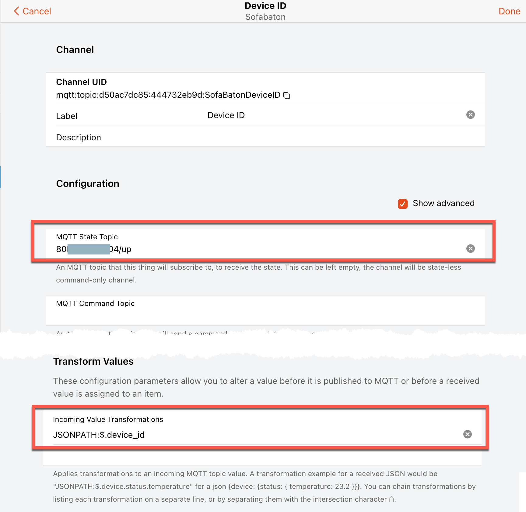

5) Create channels to receive data sent from Sofabaton
Create 2 channels: one for the Device_ID, one for the Key_ID. In both of these, add your ‘topic’ from the Sofabaton command into ‘State Topic’. Remember to add the ‘/up’. So your command should be:
[mac-address-of your remote]/up
You don’t need to enter the command topic. As Sofabaton currently only supports sending commands from the remote to Openhab - ie, it’s state read only.
Now here’s the fun part….
We are going to need to handle the format of the JSON payload coming in from the remote.
Click on ‘Show Advanced’ on your Channel. Enter the incoming Value Transformation as:
JSONPATH:$.device_id
or
JSONPATH:$:key_id
Note: you’ll need to make sure you already have the JSONPATH transformation binding for this to work (I assume you probably do if you are already using MQTT). If not, add it from the bindings add-on store).

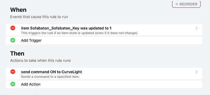

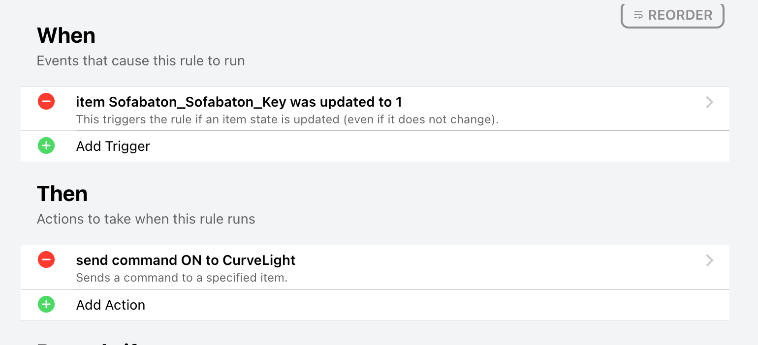

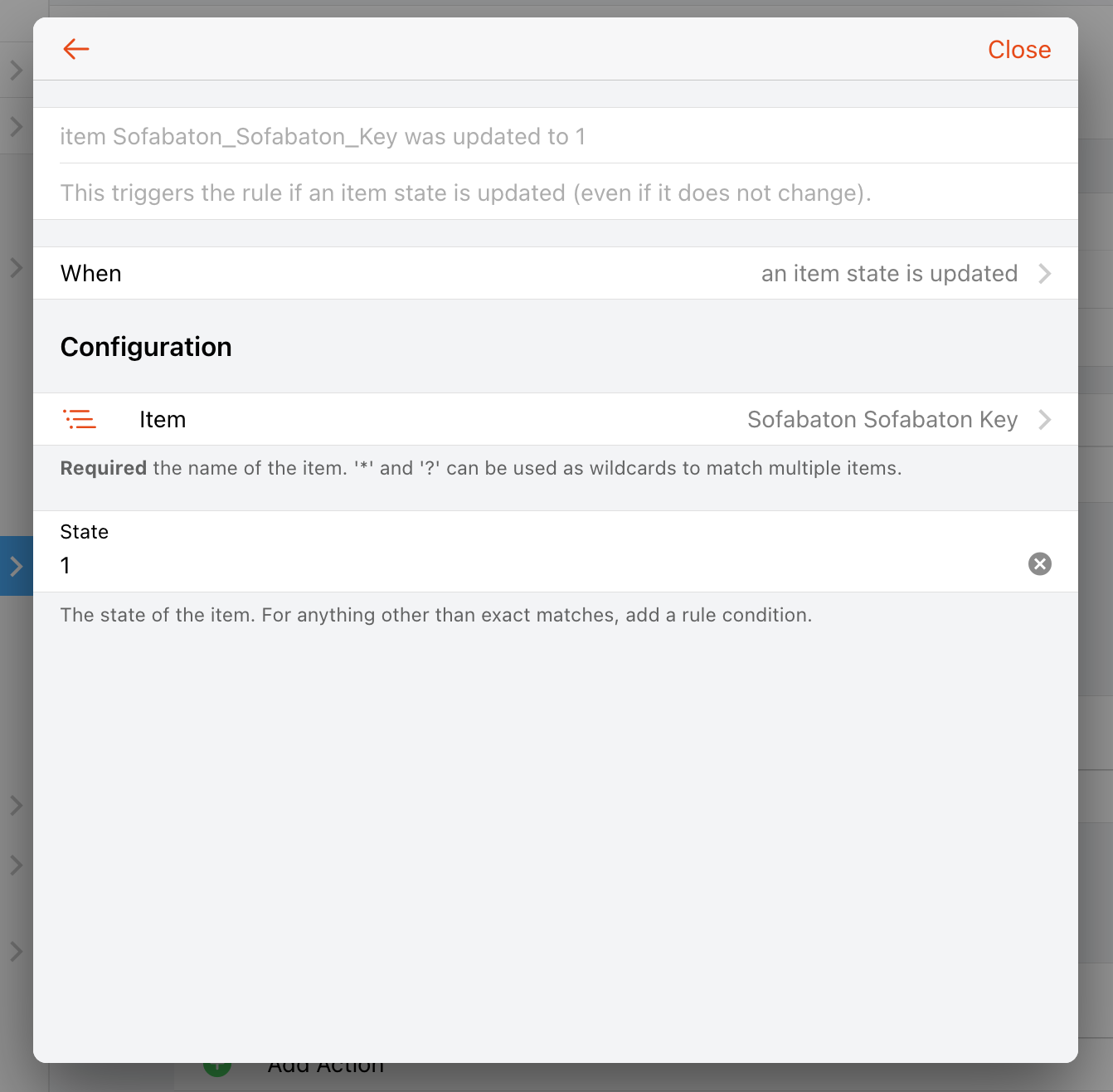

8) Create a rule to manage your Sofabaton commands
You’ll need to create a rule (or rules) to handle the receiving commands and perform your desired actions. You could create one rule for each button directly in the rules UI. To do this, make sure you choose the ‘Was Updated’ trigger:
This gets very messy once you have a few buttons. And if you end up with setting up multiple devices, it’ll be unmanageable.
