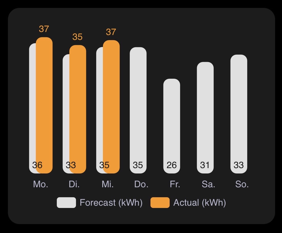

Solar Forecast & Production Chart
A minialistic widget displaying forecasted and actual solar production for the current week.
Forecasted and actual values are displayed using a bullet-style bar chart.
The data is retrieved from persistence, with both Item and persistence service configurable per series.
Additionally, series colors and labels can be customised.

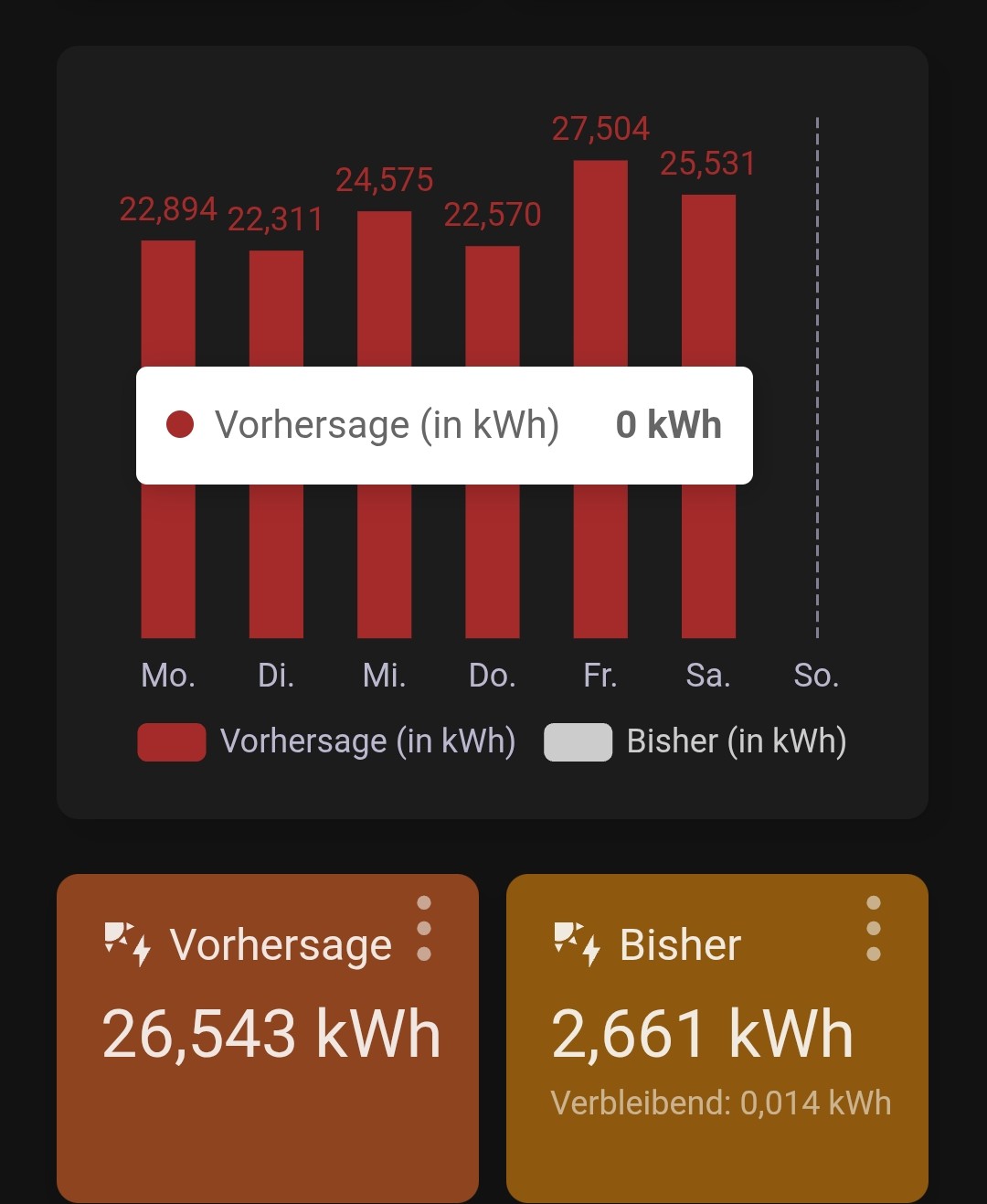

@florian-h05 Thank you for this cool and useful widget.
I have a minor issue with the forecast values. Not sure if it is related to the widget or the aggregated data. The forecast value for Sunday is not shown. IIRC the aggregation function last (Latest) is used.

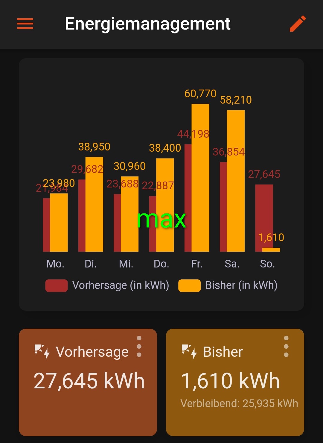

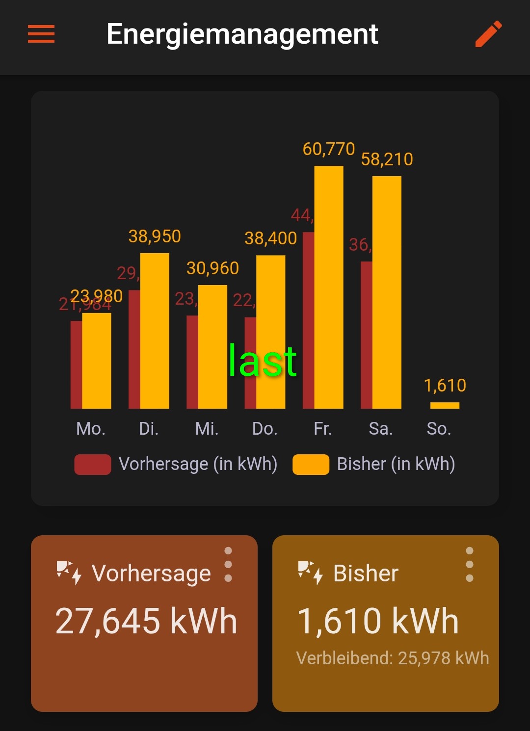

last is used for the actual value, for the forecast, max is used. Did you try out other aggregation functions?

I tried to use a different aggregation (max) function today. This is working.
last does not work with forecast values.
The widget used max for forecasted and last for actual values, see my message above.

I changed your original widget code because I like to use different aggregation functions other than yours for my charts. I am using last for aggregation of forecast energy values and diff_last for energy production.
At the moment I have the slight feeling that there is an issue with the aggregation of forecast values when using the aggregation function last. Not only in the widget but in charts too. On Sundays the aggregated value of Sunday is not shown in a chart with dimension isoWeekday.
// edit: When using the aggregation function max in my setup the value for Sunday is shown.
Do you know have an idea what I am facing? If not please ask again.
