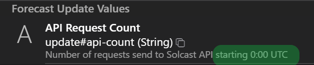

Sure, if you’ve installed on older version you’ll run quickly out of the call budget restricted to 10 calls per day per PV plane.
Budget is resetted by Solcast for all users at 0:00 UTC. It’s described in readme and shown as tooltip on the item.
Hopefully this is also well described in readme.

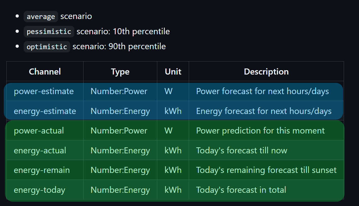

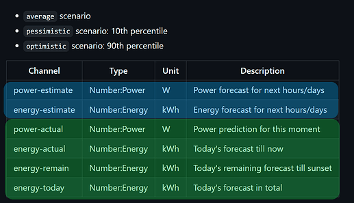

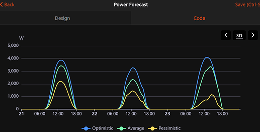

While the green highlighted channels are showing actual/today values the blue channels are showing the future. You can visualize them using this tutorial.
The items attached to channels are nice to create a dashboard and graphs but I personally don’t use them for calculations.
Now let me forward you to the rule action section of readme and the corresponding examples.
You can easily transform the example into next 6 hours energy forecast adapting the endTimestamp. Feel free to define start point, end point and duration of your energy query.
