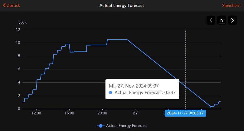

Hi @weymann
tonight the API of the Forecast.solar service went out of service. This is causing troubles with the timeseries updates and hence my rules failed. This is a bit unexpected as the timeseries contains forecast data for today so the items it fills should be valid even w/o an update through the API, no? My rules depend on the item ForecastSolar_Site_Remaining_Energy_Forecast as well as the forecast for “tomorrow” generated through the Actions:
val RemainT = (solarforecastActions.getDay(LocalDate.now.plusDays(1)) as Number).floatValue
Is there any chance to ignore the API problems as long as there is forecast data fetched already and fail “nicely” once the timeseries data runs out?
Here the logfile when the API went out of service:
2024-11-26 22:44:46.566 [INFO ] [hab.event.ItemTimeSeriesUpdatedEvent] - Item 'ForecastSolar_Site_Energy_Forecast' updated timeseries [Entry[timestamp=2024-11-26T06:40:11Z, state=0 kWh], Entry[
timestamp=2024-11-26T06:45:00Z, state=0 kWh], Entry[timestamp=2024-11-26T07:00:00Z, state=0.01 kWh], Entry[timestamp=2024-11-26T07:45:00Z, state=0.021 kWh], Entry[timestamp=2024-11-26T08:00:00Z
, state=0.185 kWh], Entry[timestamp=2024-11-26T09:00:00Z, state=0.6 kWh], Entry[timestamp=2024-11-26T10:00:00Z, state=1.251 kWh], Entry[timestamp=2024-11-26T11:00:00Z, state=2.3 kWh], Entry[tim
estamp=2024-11-26T12:00:00Z, state=3.949 kWh], Entry[timestamp=2024-11-26T13:00:00Z, state=5.707 kWh], Entry[timestamp=2024-11-26T14:00:00Z, state=6.91 kWh], Entry[timestamp=2024-11-26T15:00:00
Z, state=7.589 kWh], Entry[timestamp=2024-11-26T15:05:07Z, state=7.609999999999999 kWh], Entry[timestamp=2024-11-27T06:41:40Z, state=0 kWh], Entry[timestamp=2024-11-27T06:45:00Z, state=0 kWh],
Entry[timestamp=2024-11-27T07:00:00Z, state=0.017 kWh], Entry[timestamp=2024-11-27T07:45:00Z, state=0.021 kWh], Entry[timestamp=2024-11-27T08:00:00Z, state=0.255 kWh], Entry[timestamp=2024-11-2
7T09:00:00Z, state=0.791 kWh], Entry[timestamp=2024-11-27T10:00:00Z, state=1.594 kWh], Entry[timestamp=2024-11-27T11:00:00Z, state=2.5220000000000002 kWh], Entry[timestamp=2024-11-27T12:00:00Z,
 state=3.434 kWh], Entry[timestamp=2024-11-27T13:00:00Z, state=4.292 kWh], Entry[timestamp=2024-11-27T14:00:00Z, state=5.021 kWh], Entry[timestamp=2024-11-27T15:00:00Z, state=5.51 kWh], Entry[t
imestamp=2024-11-27T15:04:18Z, state=5.522 kWh]]

Within the maintenance window (Estimated: 2024-12-04, 04:30 - 06:30 CET) I received no ERROR in the logs? The window was a bit longer than predicted, as I didn’t receive any updates on my items from 26th 23:06h until 27th 09:07:
My rules don’t rely on channel-information, but on item information. So my rules did not crash, but just worked with “outdated” item-information for the API downtime. After 9h today everything worked with the API again, and the items’ values got updated.
Hi Thomas,
well, the maintenance window (Estimated: 2024-12-04, 04:30 - 06:30 CET ) is yet to come :wink: The outage was unexpected.
I guess my rule is failing due to the Action failing. Do you use your own forecast Item for future data? How?
As for the binding, I guess the timeseries is using the default policy which is “replace” so all future data went away. How about changing that to “add”? Would that help to bridge the outage?
Thanks!
hihi. sorry, overworked, lack of coffee! :wink:
Past me did all that and present me forgot. So I had to take a look:
  1. I don’t rely on future power forecasts (Actual Power Forecast), but on the “daily aggregated” forecast (Remaining Production Today).
  2. I mix it with predictions on how much energy my house will need (EV charging, heating, washer/dish washer,
), but only after sunrise.
  3. And with all that I fill a custom proxy item with the “free to use” prediction, again only after sunrise and before sunset.
So, when the outage occured today:
  • Remaining today item: stayed on “0” from 17:07h yesterday and got to 17kWh at 00:37 today
  • so my aggregated item stayed 0 (sunset to sunrise no change) until 08:12h, when the sun was on the right height to produce the first Watts of power.
But! You’re absolutely right. If you rely on a future timeseries, an outage should not “destroy” the timeseries, but keep the latest values.
As I said past me wrote the rules, when timeseries was not present, so I did not take that into account. :wink:
