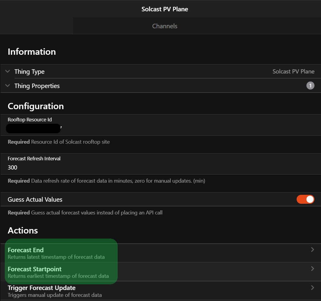

There’s always the full day available. You can check this with the rule actions getForecastBegin and getForecastEnd. Note: It’s showing UTC date time, not your local date time. You can execute them via UI which is quite handy!

While the green highlighted channels are showing actual/today values the blue channels are showing the future. You can visualize them using this tutorial.

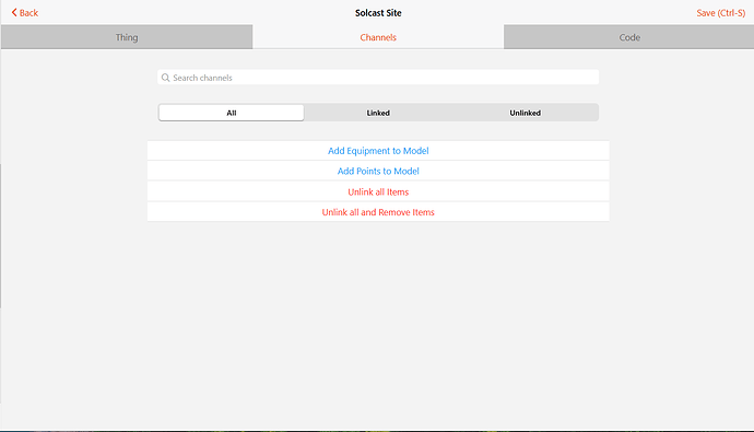

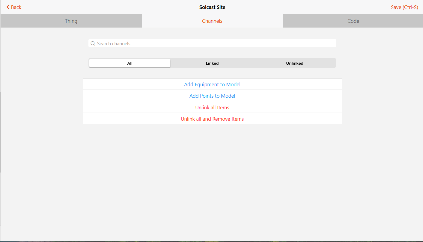

I removed the binding and reinstalled it. Now for some reason the channel lists for Solcast Site, Solcast PV plane, Forecast Site and Forecast PV plane are empty, see e.g. the screen copy for Solcast Site
Okay, but if’s working why do you reinstalled the bundle? Bindings are mostly coupled with the running OH version because there are dependencies.
Any trace output after reinstalling the binding?
For analysis which OH version do you run and which binding version (Marketplace, official version/ addons folder) did you install?
I’m running OH4.3.3. and for some reason I had 4.2.0 jar file in the addons folder. I deleted this file and then I restarted OH. When I looked at the Add-on Store Solarforecast binding was not installed so I installed the binding under Add-on Store.
I managed to solve this problem. I just deleted the Solarforecast Items and recreated them. Everything is now working.

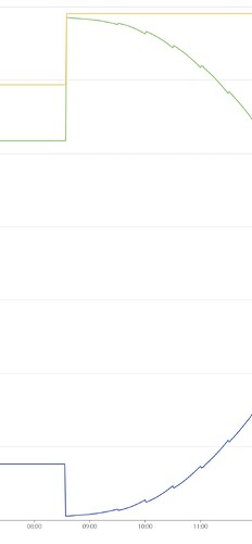

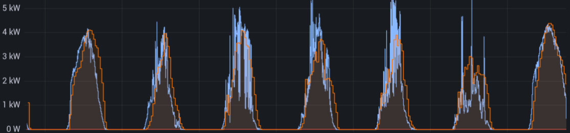

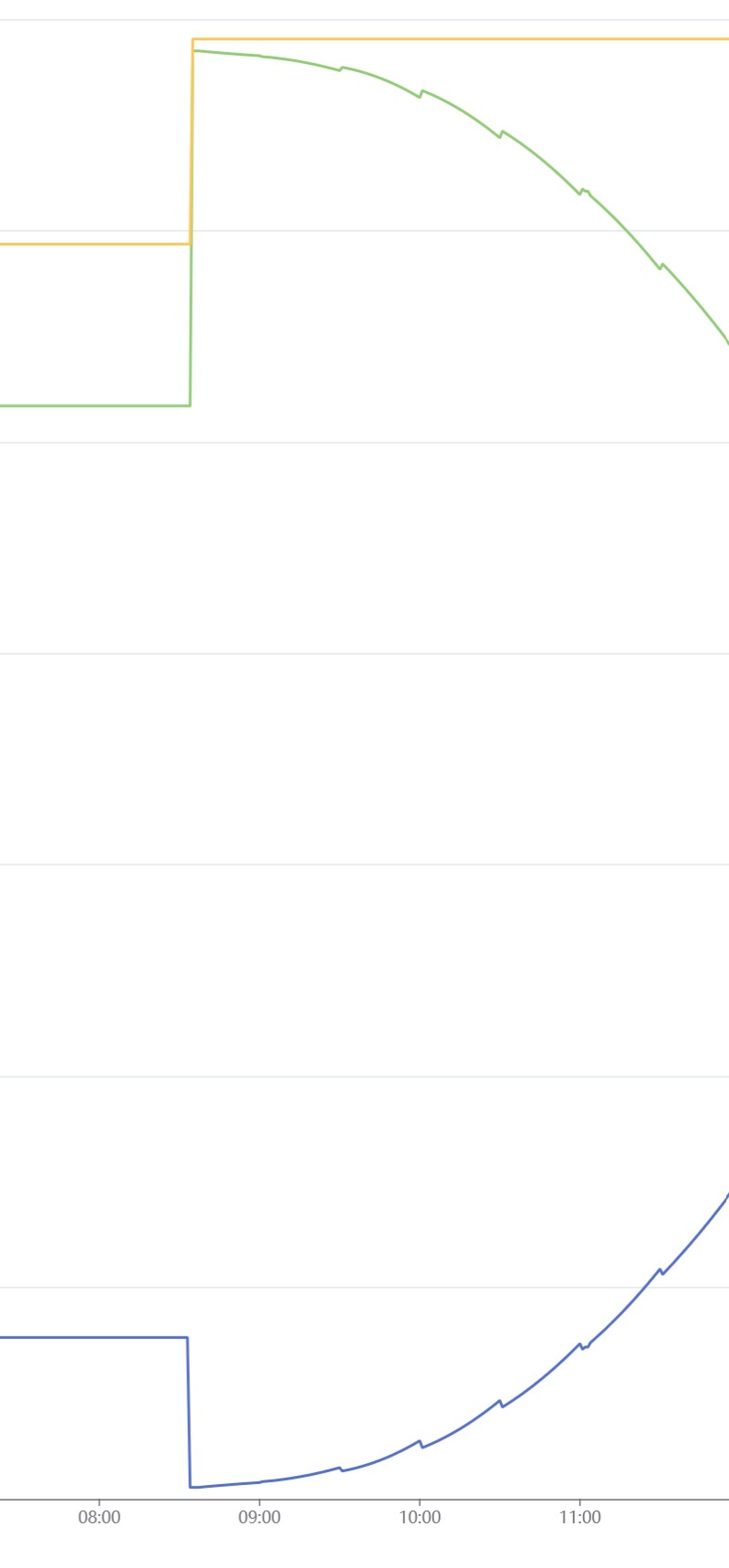

It looks like the forecast (orange) is running +1h compared to my actual production (blue). This is SolcastHomeAveragePowerEstimate.
I’ve check my timezone in OH, it’s set correctly to GMT +1.

From the graph showing a week it’s hard for me to see a 1 hour drift. Can you please zoom in into the graph, espacially showing which time the forecast starts and which time the forecast ends?
