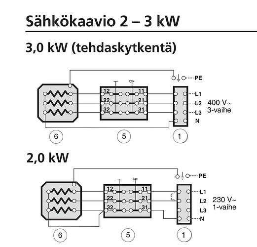

Yes, it’s a Nibe Haato 300, the manual shows the two connection options:
  • 3 kW with three phases (this is how it is currently connected, my relqy + contactor cuts / allows all 3 phases)
  • 2 kW using a single phase
According to the electrician I talked to, I could achieve the 1 kW / 2 kW / 3 kW steps simply by controlling the three phases individually.
Yes, you can control the 3-phase system by controlling each phase separately but the step is 1kW which means that you can’t use the excess PV power effectively. The 1-phase system is easier to control with a PID controller and a SSR. Your boiler has 300 l of water so 2kW heating power is not perhaps quite sufficient.
