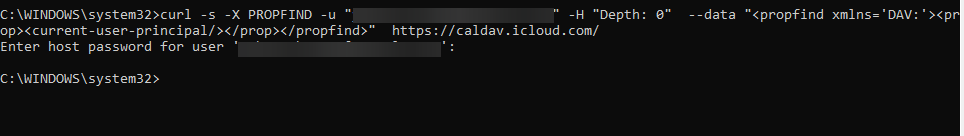

Hi there, the first command asks for the password but the app-specific password or any password, even wrong, doesn’t respond anything:
Any suggestion? Thanks.
Hi Andrew, thanks for the posts, tried hard to get my CalDav solved, but after entering the command with my appleID , I am prompted to enter host password - but my console does not accept any character anymore - do you have an idea what could be wrong?
Thank you! Sorry, I’m not familiar with program codes.
