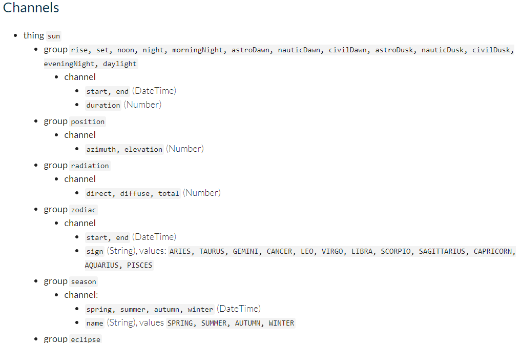

In the Astro binding documentation is looks like there is a Radiation group for Sun…
Radiation
Sun

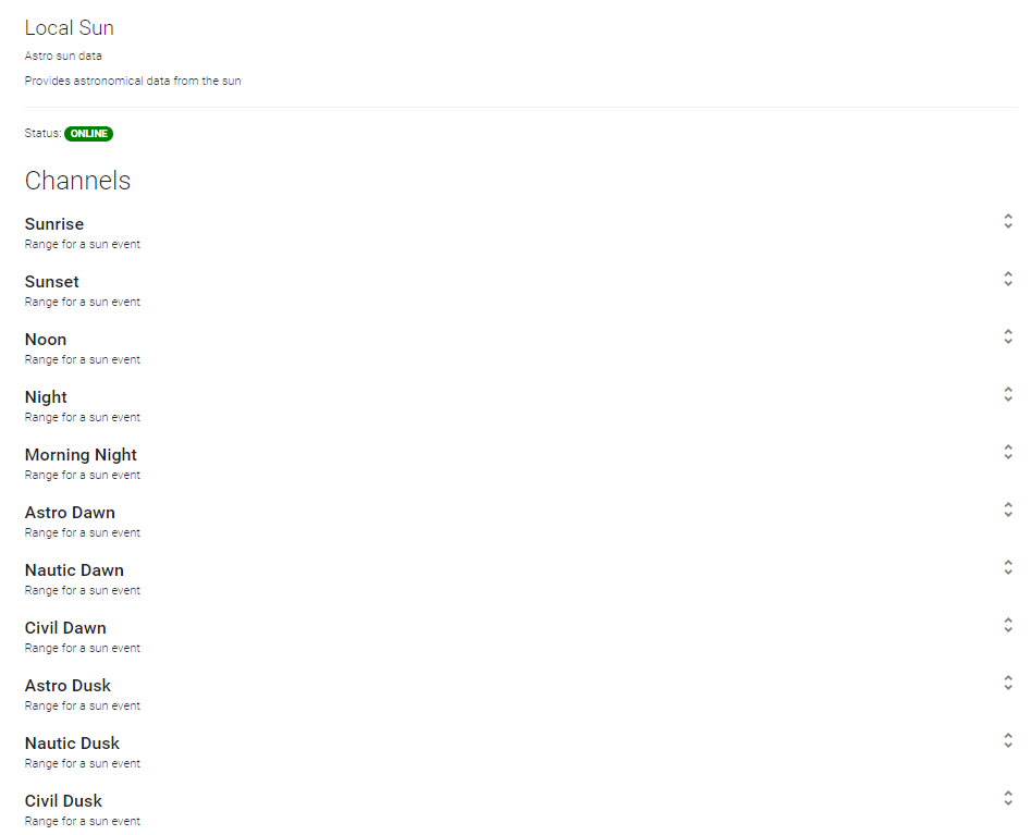

However, in the PaperUI properties for Local Sun I see no such group:
Local Sun
All the other group are there, the only one missing is the Radiation group… Is the documentation wrong?

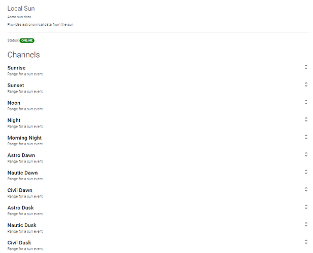

I have that group:
I’m on OH2.1 stable release, bundle:list shows version of Astro 0.9.0.b5
My version is:
openhab> bundle:list -l | grep -i astro 201 | Active | 80 | 0.9.0.201707190720 | Astro Binding | mvn:org.eclipse.smarthome.binding/...
Solved by removing thing Local Sun and re-adding it…
In this case you had Thing “Local Sun” and have updated the binding. In case of a change in the channel(s) of a binding, those changes will only be observed on things that are created with the updated binding! I observed the same on other bindings.
