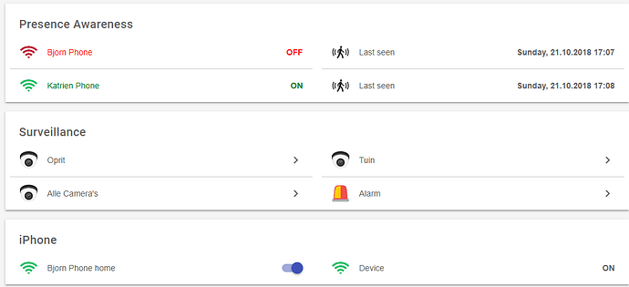

seems that once ur code has been triggered as “online” it does not go back to offline.
tried do disable my wifi on my phone and then changing group and go back over and over untill yours or mine jumps offline.
Result:
or do i understand this wrong?
Is the bottom phone the one just added?
Your correct, in the items file I use the expire binding as a timer. This helps with false presence e.g. I walk over to the neighbors for 10 min. my presents remains. When I’m away for 20 min then I’m detected as away and can use other rules to turn off lights and such.
You can adjust the 20 min to suit your needs.
the bottom one is indeed yours with a few small name changes.
Been testing some more in the mean while :slight_smile:
Your “Bjorn Phone home” and “Device” what you see in the screenshot does not seem to ever go in a “off” state for me.
Although i changed the expire to 1m.
But when i disable my wifi on the phone and manually set ur switch to off..
And then turn on wifi on my phone.. i start by clicking “open group” and going back “Home”, and doing this over and over to “refresh”.
Omg, your button instantly changed to “on” after 1 “refresh”
Then after about 4-5 times (and often more) opening the group and going back, finally my button jumps to a “on” state.
Then again my button goes back to “off” when disabling wifi on my phone, this does require more about 15 refreshes, did not count it but it takes ages :stuck_out_tongue:
I dont see much difference beside that in my code i also use “lastseen”, but this should have nothing to do with this i think.

I also noticed that when my phone goes to sleep that my button will jump to off, which is arping i need to fix if this is an issue.
But just browsing or w/e on my mobile makes my button go back to online.
Once my button would show “off” because my mobile is a sleep i tried turning your button to off, though now it does not jump back on by itself by browsing.
Again.. wifi off and on makes it instantly show “on”

so i make up that its registering the correct value.
Only the button does not change, even after refresh
I never used or tried to use the switch, its just an indication, you can change that to something else if you like.
Why it’s not updating on the sitemap is strange. Have you restarted OH after making all the changes? Sometimes that is helpful when making sitemap changes.
restarted openhab again.
Opened my sitemap with my wifi disabled.
Enable wifi.. and without any refresh my button instant becomes green..
after 1 min your button becomes green without refresh.
Turned of wifi and waited.
About a minute and my button becomes red again..
5mins in the newly created one is still green, even refresh does not change it.
So just as an extra test i just turned on wifi and again my firstly created button instantly turns green..
i am getting confused :slight_smile:
that would mean there never was an issue..
i dont believe it.. wifi back off!
about 1 min and it turns off automatically.
