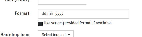

In HABPanel, use a dummy item and tick the server-provided format checkbox
That was what I did.
In the meantime I deleted the HABPanel and created new after your post. Now both fields are empty?!
Did you also try to use the format field in the dummy item, for example:
dd.MM.yyyy is working :wink:
Thank you!!!
