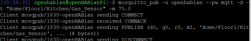

I subscribed to my topic and when I publish a message to it this is the result:

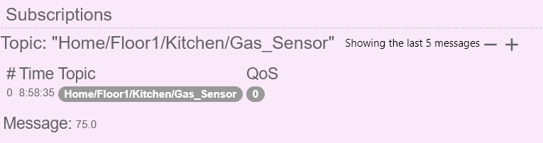

I also subscribed to the topic via mqttLens and the published messages arrive there:

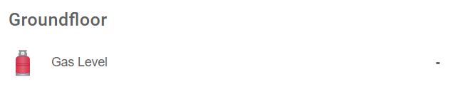

But the message does not change the item state the Gas Sensor item keeps showing “-” on the sitemap:
What am I doing wrong ?
