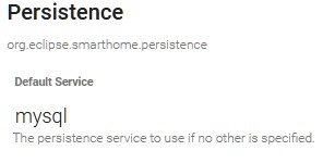

What I was looking for a specific answer for was, what is your system’s default persistence service set to today? Because your changedSince()
relies totally on that setting to select where to get the data from. You want it pointing at mysql.
