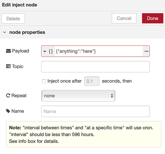

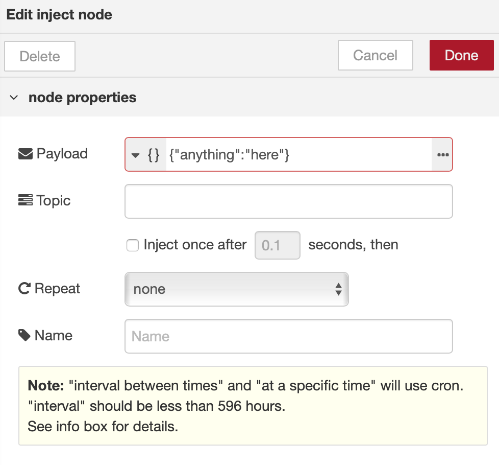

Hint for seeing what is available for any item:
Make an inject node that looks like this and send it right into a homekit item:
Then check out the “debug” in node-red where it will list all items available for that item (air purifier for your example).
This will make more sense in a little bit when I get my examples loaded.
