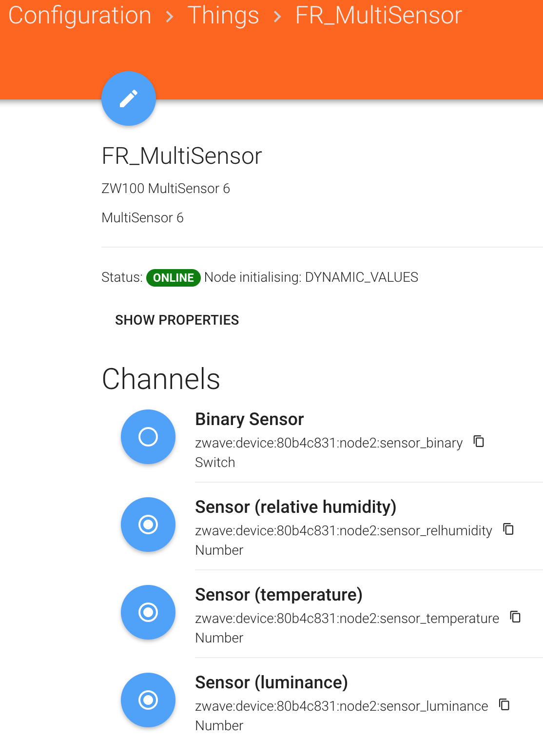

Ok, now go to the Sensor Thing in PaperUI and check the Channels and their links to Items. Remember clicking on the Blue Circle?
Sorry @psych, I’m not sure what a code fence is. The sensor seems to be online and channels are defined.
Yep, they’re all linked to items just as before the problem started.

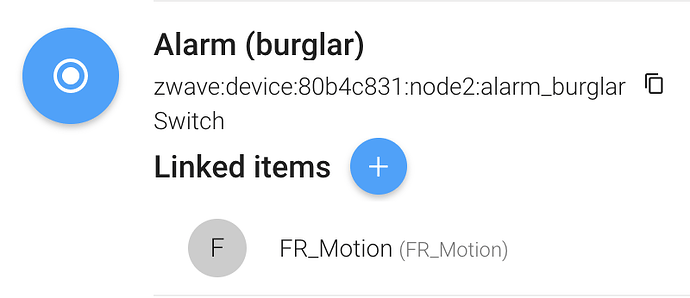

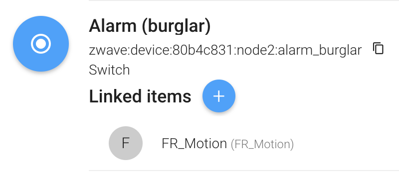

Confirm that the Alarm Channel is linked like we set it up the other night.

Yep…
Yes it does.

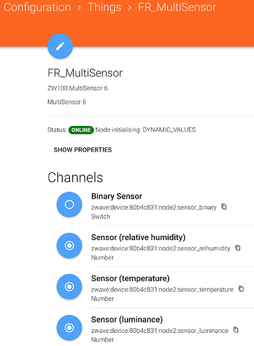

Am I the only one who has noticed the node has not yet initialised? Check the picture, its in it’s DYNAMIC_VALUES phase
No, I didn’t notice that. That’s probably it.

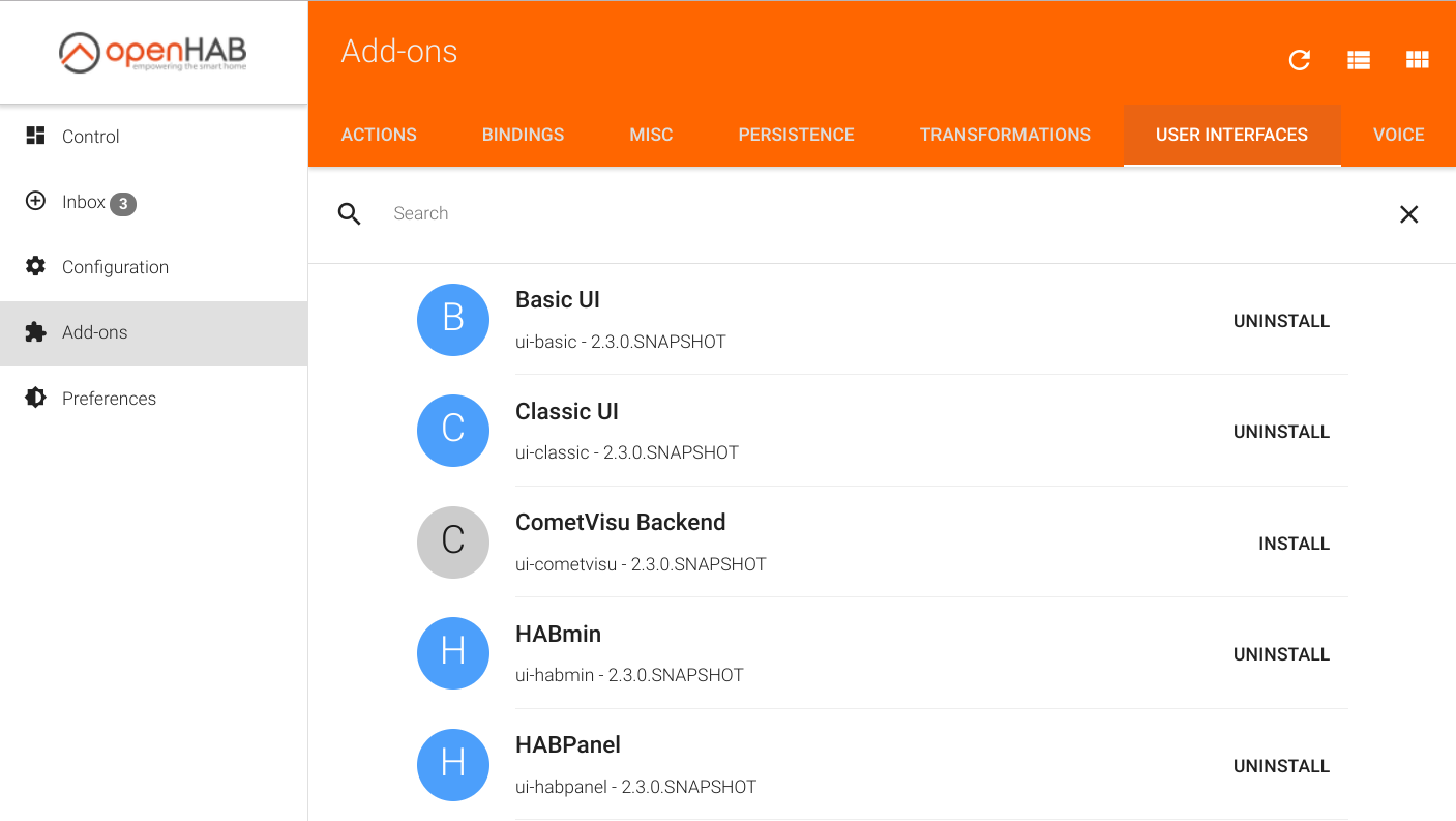

Go watch this video. You can learn a little about HABPanel by watching from the 6:55 mark. You need to install the HABPanel UI. See Screen shot below.
