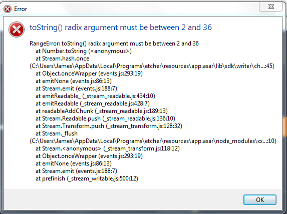

Hi
I formatted SD card using SD Formatter. When Etcher gets to 100% it crashes with an error about “radix argument” and leaves sd card unaddressable. Does anyone know what this might be? Tried 3 times with identical result. SD card is 16GB.

there is an pretty new issue for that on github:
https://github.com/resin-io/etcher/issues/2518
unfortunately no solution but it seems to happen also with different images.
But i would try re-downloading the image again as @vzorglub suggested.

Can you recommend alternative software other than etcher which sounds as though there is a problem with windows 32 bit. p.s. i have redownloaded the xz file with no change of behaviour.

Win32 disk imager should work but you need to in compress the image first.
Thanks. I have now succeeded with 7-Zip and Win32DiskImager.
