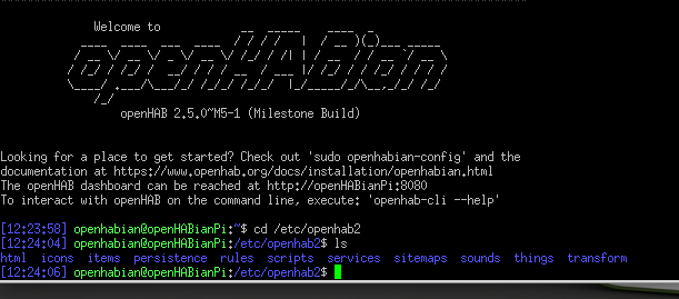

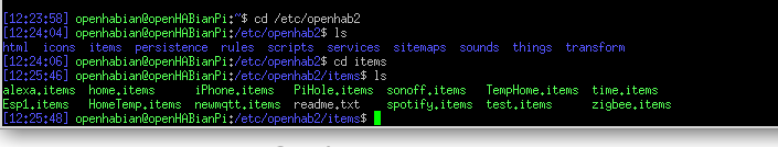

I have openhabian installed on RPI. Where are the files I would edit if I do it that way. The file structure looks different to the way described in other posts.
File for things, items, stiemap, etc… are all in etc/openhab2 just use ls command to get a list of all directories.
Screenshot at 2019-12-07 12-24-44
