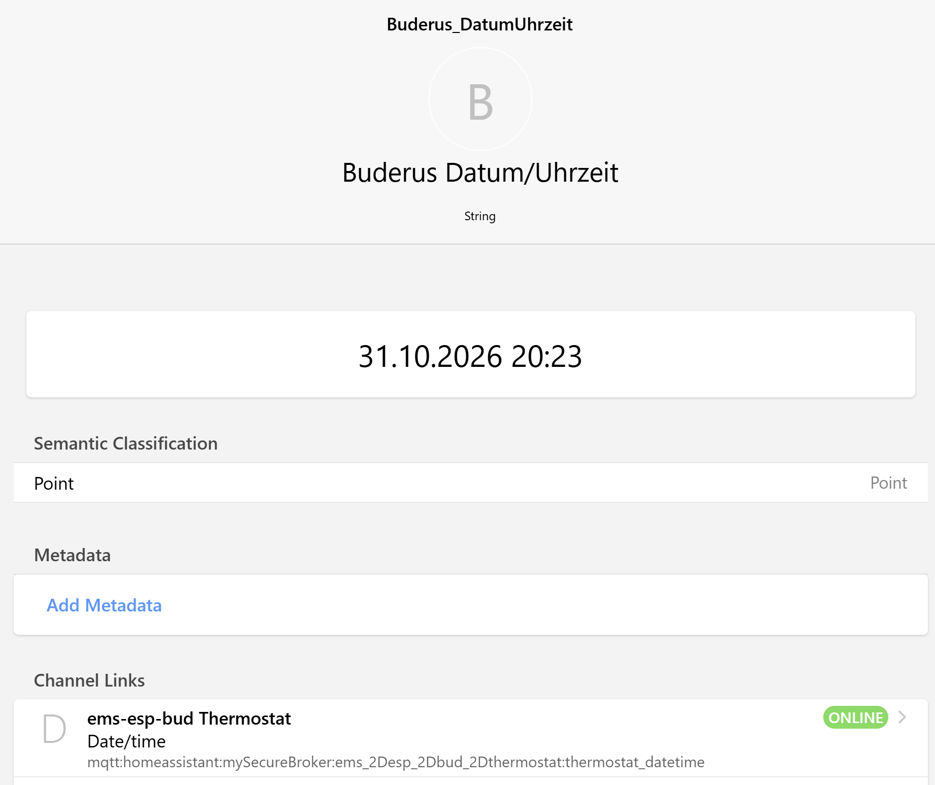

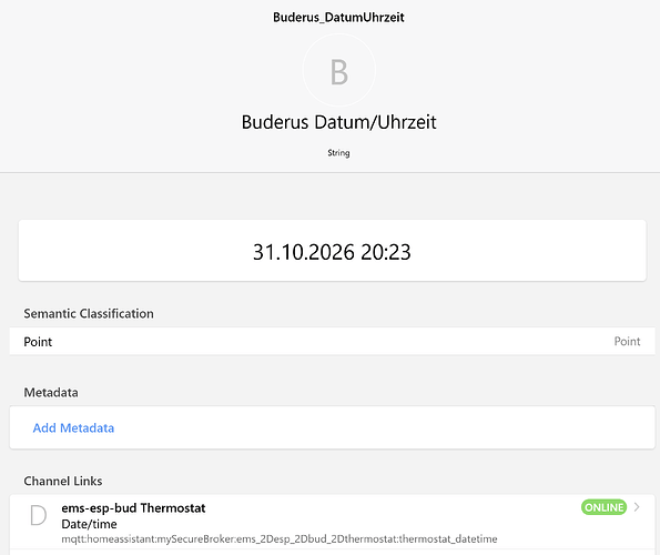

But the channel for date/time delivers the date and time as one string in the format: 31.10.2025 20:23
I have linked the channel to a String item but I would like to have date and time in separate items but I am too stupid to get this done … In the past I did everything in the items file but I wanted to modernize my behaviour and do everything via the UI and I fail:
Here is a screenshot of the current date/time item which is in the string format
I kindly appreciate any hint and support to help me to divide the full string in two separated items for

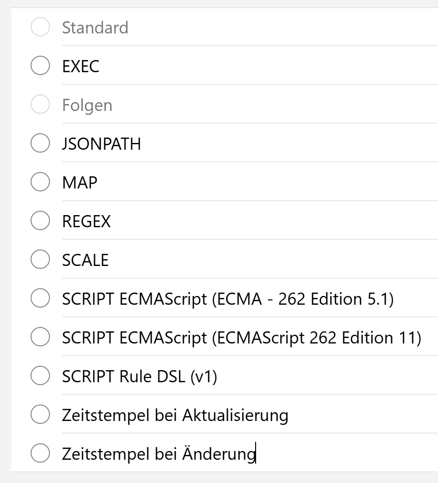

When I choose DateTime as

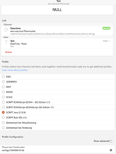

I can not select the “Standard” profile anymore and I do not know what to select there to create the item

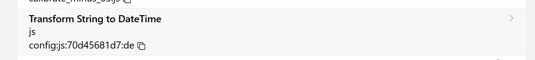

I have created a JS = javascript transformation script with the content above as is looks ok for me:

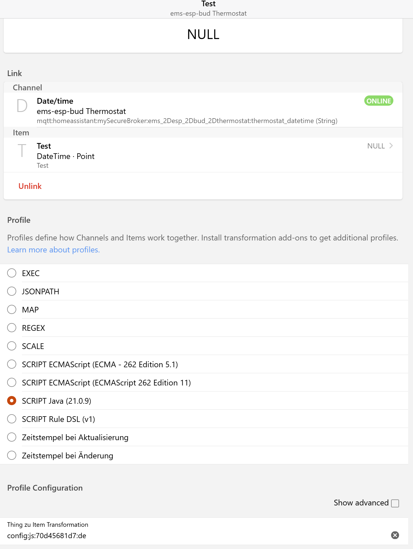

I have created a new link to an item from the thing channel and I have put the UID of the transformation script in the profile configuration’s first line “Thing to Item” (= your Channel to Item) but it does not work …
