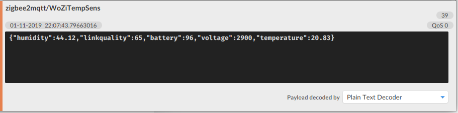

with MQTT.fx i can see my devices e.g.
zigbee2mqtt/WoZiTempSens
with following payload
“humidity” : 43.39,
“linkquality” : 55,
“battery” : 96,
“voltage” : 2900,
“temperature” : 21.53

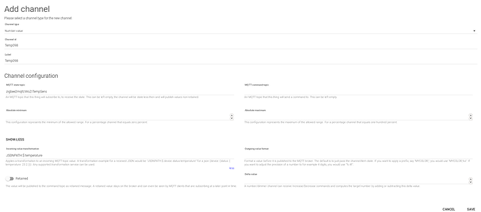

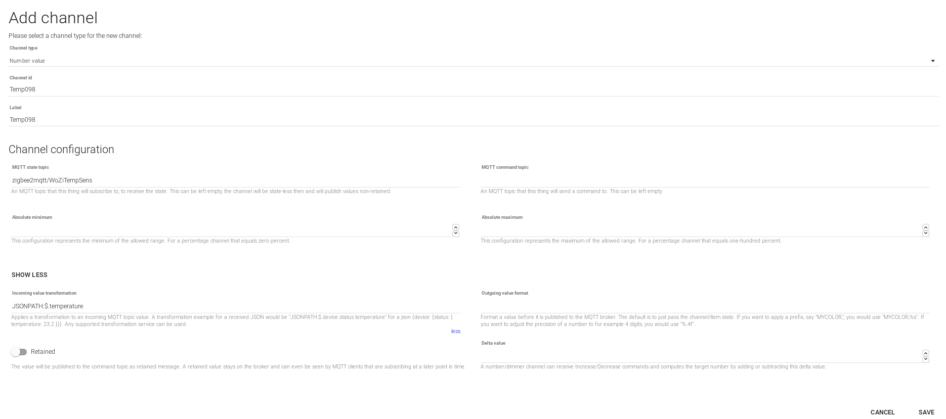

if i try to add a generic mqtt think the thing say online as well if i try to add an Channel i have problems again.
if but the setting as shown the generic mqtt think is immediately offline with the message Status: OFFLINE - COMMUNICATION_ERROR java.lang.Exception: No MQTT client
