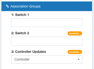

Hmm, looking into associations…reading thread about lifeline associations…when I check my nodes in Habmin there is no association in any of them ? Should there be ? All other nodes are working properly.
EDIT: Added “controller” to Switch2 and magically it now works. Got to understand this thing about associations
Yes.
Association groups defined in the database not pointing to the controller (in this case Switch 1 and Switch 2) are used for direct associations between two zwave devices without even involving openHAB.
Setting these to the controller would cause unnecessary traffic in your zwave network and even cause problems.
If you want updates from your zwave devices to openHAB, just set one (the correct) assocation group (in this case Controller Updates) to your controller.
