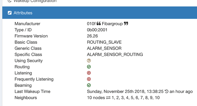

I have two OpenHAB 2 installations in different locations. I have a Fibaro Z Wave flood sensor (FGFS101) in both locations – one has been working great, but I cannot fully configure the one in the newer installation. Specifically, the list of channels is not appearing in the newer installation. Here is what the configuration looks like in HABmin on the newer configuration:
The “Channels” section is missing. Can anyone help me figure out how to fix this situation? How can I get the “Channels” to appear in the newer configuration.
Here is some additional information about my configurations. The two flood sensors appear to have the same firmware version (26.26, as shown above). Likewise, the “Type/ID” for both are the same (as shown above).
Both OpenHAB systems are running on Raspberry PIs (the older is on a RPi 2 and the newer on a RPi 3). The older installation was performed manually but the newer system is based on the OpenHABian disk image (a very nice addition). However, they are both running the same version of OpenHAB (2.3.0-1)
