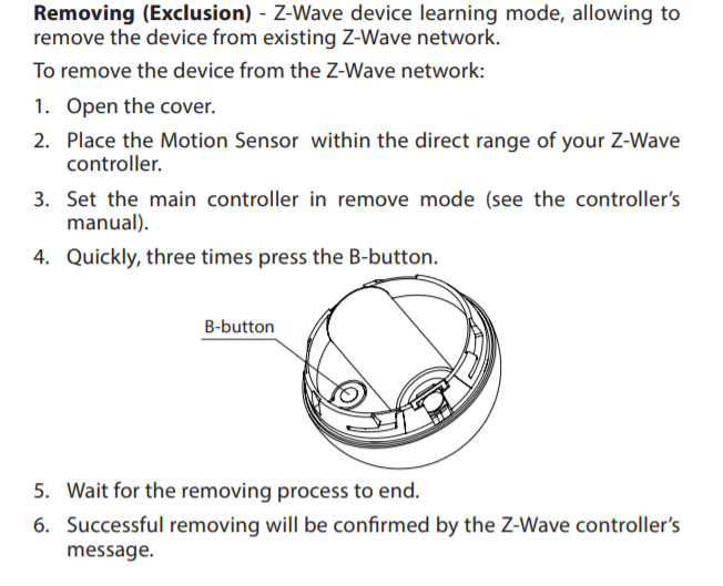

I did the following trying to remove the device.
  1. Place the controller into Exclude Devices Mode
  2. Pressed the B button of the sensor three times as described in manual. The sensor was close to the controller. Nothing happened. No removal confirmation.
  3. I removed all channels and deleted the thing. This was successful
  4. Placing the controller into adding mode of the device immediately discovered my sensor with previous node number. So i followed and configured the thing again. Unfortunately observation was the same. I did not received any updates.
I repeated steps 1, 2 and in addition I pressed remove the device from controller under the thing mode
Also without success.
Next step would be more hard, removing the node directly in my controller (USB-ZWave Serial controller Aeotec).
Before doing that maybe someone could provide the feedback on the procedure. Is it the right one? Why I did not receive any feedback from the controller about removing the device?

Can someone confirm the removal process, please?
  1. Using HABian I go to Z-wave controller, click on Exclude Devices from extended menu
  2. Press B-Button 3 times
Not I shall receive the confirmation from the HABian that my node has been removed.
Later I could remove the thing and channels. Is this right?

The two steps you describe are right.
I’m not shure about a confirmation from OH but i think there is none.
Removing the node in OH will not help, if exclusion did not work correctly. You may delete the node with the help of the “zombie” info above or try the procedure JendH descibes. This should also work on a raspi.
JensHs remark about zombies slowing the z-wave network is also right (from what i red from the community). So i always remove these non-existing devices.
You’re right there was none all the time I tried to remove the thing
