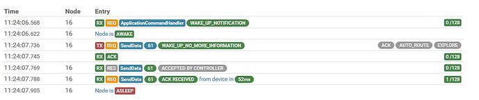

I did a DEBUG log from the zwave binding to get further information.
The debug log was started at 11:23 and stopped about 11:33:

After 11:24 take some movements but no suitable log entry comes up.
Has anyone a idea why no update is reported?

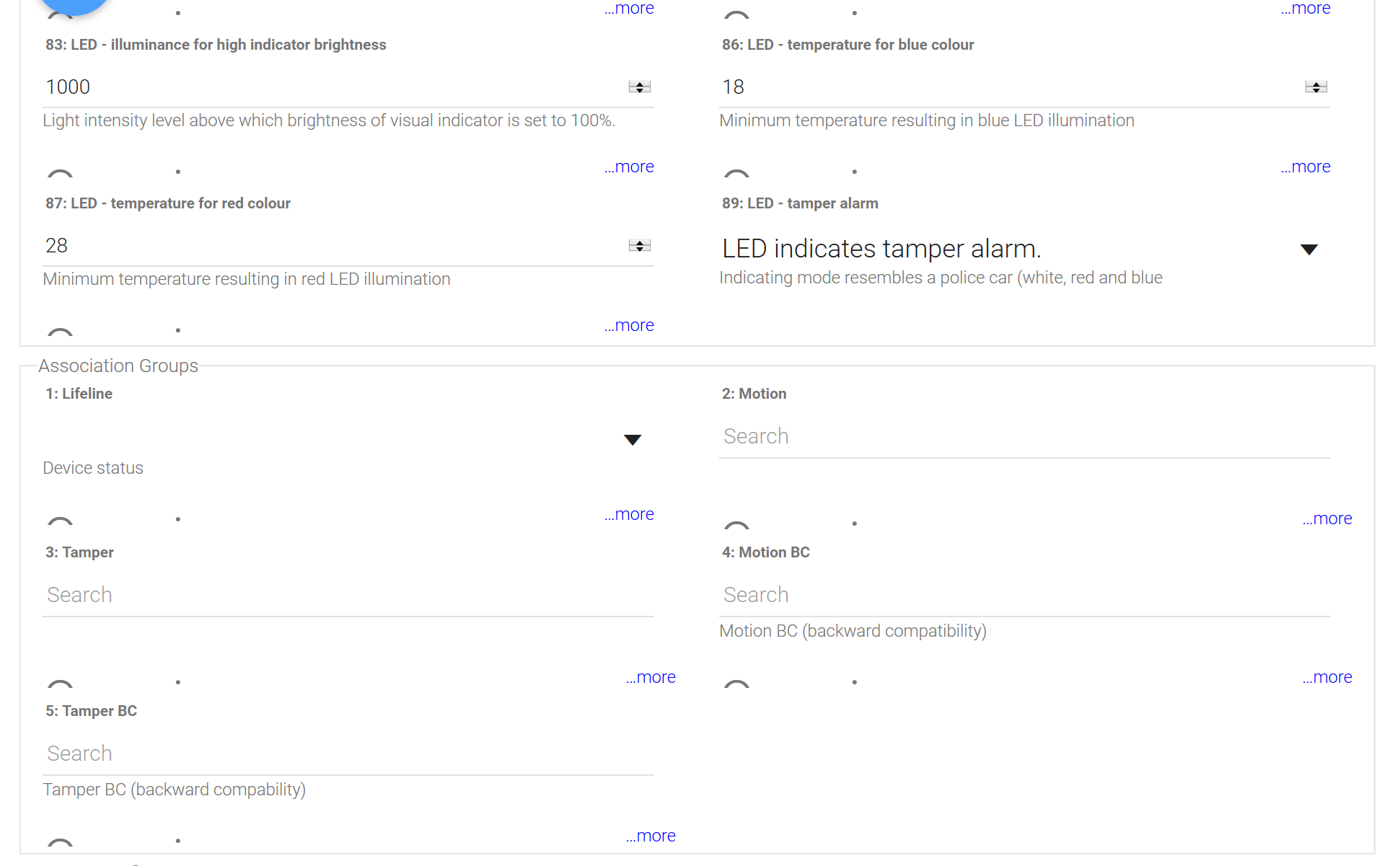

Not much in there except the wakeup:
Did you set the association group 3 to your controller? (Preferable via HABmin)
Edit: ahh, you have the newer device, in that case it is group 1 “Lifeline”. After changing that wake the device up manually (via the button inside the device)
You are the best. That was the problem :see_no_evil:
Thank you a lot
