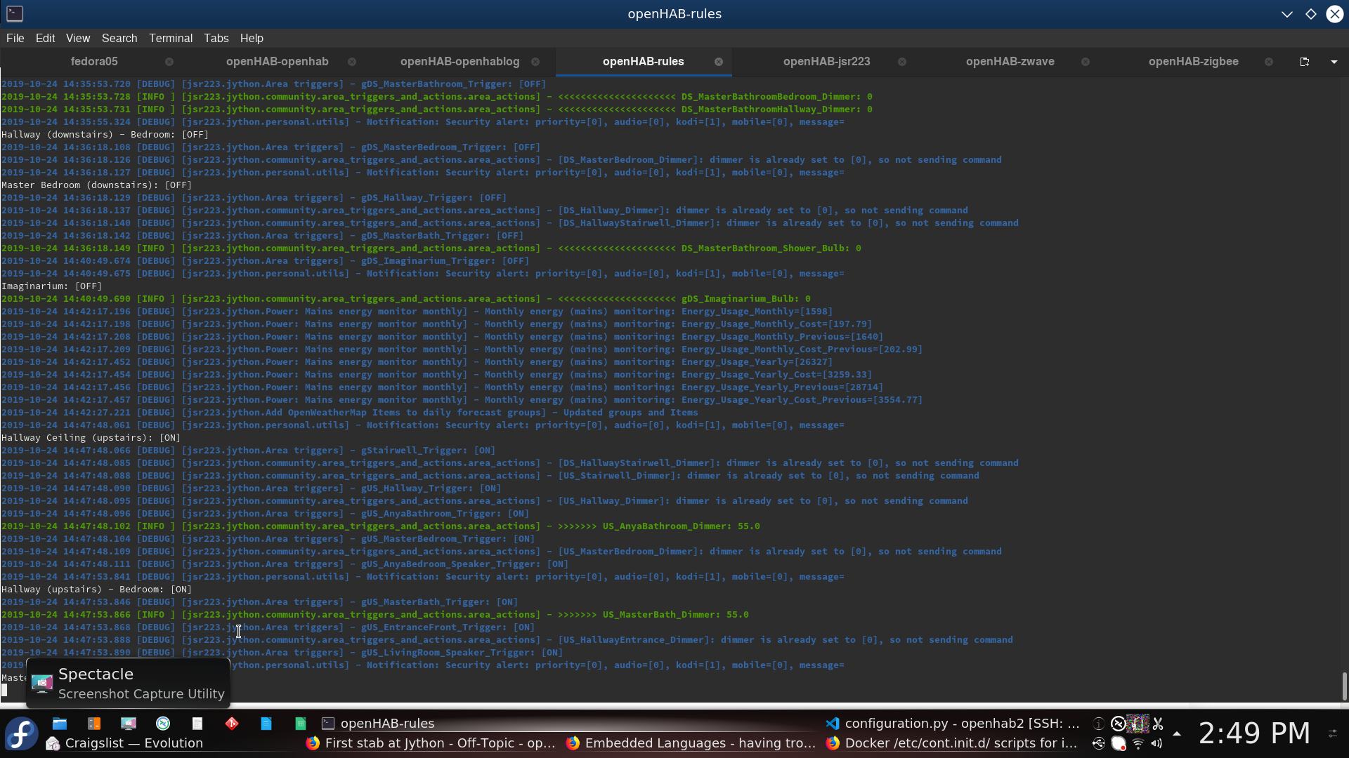

OK, these lights stay ON after the switch is moved to ON. They do not turn off when the mode changes.
What do you have in the log at the time of the Mode change?
Note: The last line it where I turned 1 plug off manually to kill the light

This is the event.log, which can be useful, but logging from the helper libraries and rules will be in the openhab.log. When someone asks for a log file, most of the time they are asking for openhab.log.
Sorry, I grabbed that from Frontail which pulls both, I thought.
Nothing really in openhab log.

Automation is something that you could turn off, but jsr223 should stay at debug. For now, set them both to debug.

 that’s in the event.log
 nothing I can do about it in the helper libraries.
Also in the other log.

There’s something that will help people
 set jsr223.jython.core to INFO. I need to get that into the docs.
