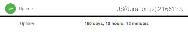

I tried the script from @rtvb (thanks), that works for basicUI, but not for PaparUI. Is there anything changed in the past two years regarding transformation within an item label?
upper part = paperui, lower part is basicui:
PaperUI is still an administrators interface for system setting up and testing etc., and is not intended to have nice presentation goodies.
Thanks, too bad. Administrator interface or not, i think it should have the transformation in place, for testing purpose etc. Anyway, with the all new UI that is being developed for 3.0 i don’t think anyone should waste their time implementing it for paperui :slight_smile:
