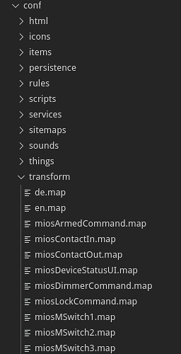

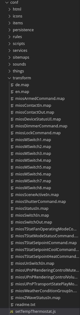

the JS file in in transform folder i tried it with and without typecast to string

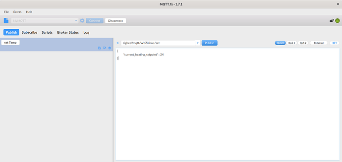

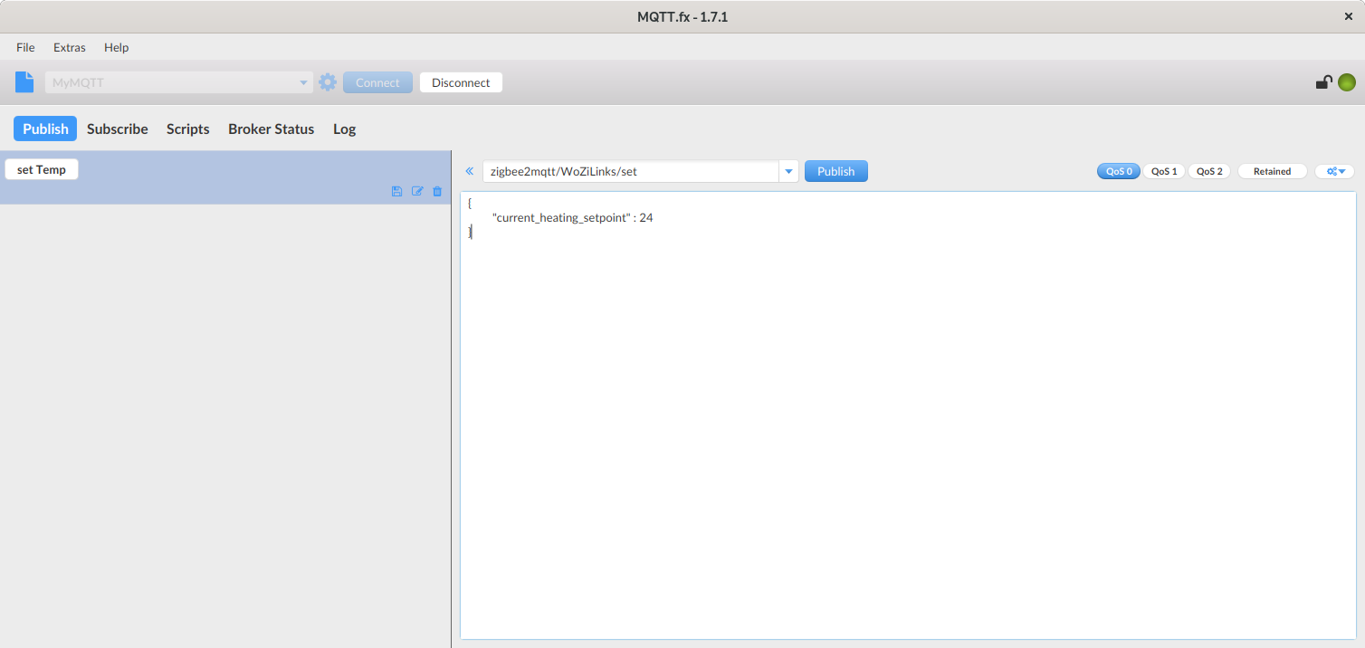

If send the json
	"current_heating_setpoint" : 24
zigbee2mqtt log say this and the thermostat change the temperature.
Zigbee publish to device 'WoZiLinks', hvacThermostat - write - [{"attrId":16387,"dataType":41,"attrData":1600}] - {"manufSpec":1,"manufCode":4151} - 1

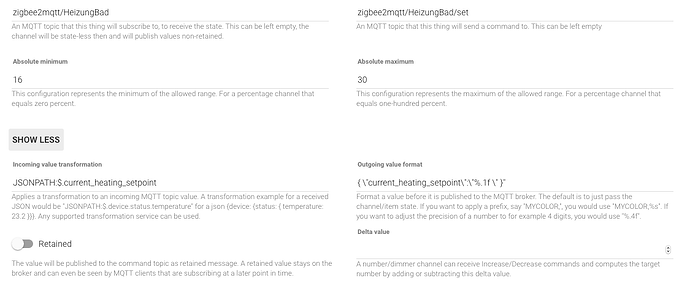

Hello Community,
i almost got the same problem. I use the 2.4 binding and need to send also the “current_heating_setpoint: xy” If i understand it, i need to configurate a converter. But this is not the same like transform? So I can not use the script from above?

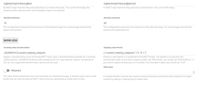

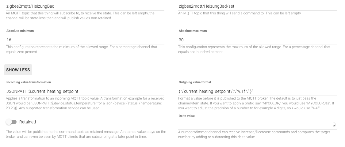

First tried { "current_heating_setpoint":"%.1f " }" now, but didnt work :frowning: Just send the information like: “30” but not in JSON.
Incoming works fine.
You need to update to 2.5 and use the outgoing transformation
ok thank you. First have to update openhab to 2.5 :slight_smile:
From your screenshot, you ended with a quote mark but did not begin with a quote mark. I do not know if it needs them, but they should be used in pairs.
thanks, but tried both versions. Just forget the first " by copy paste :slight_smile:
