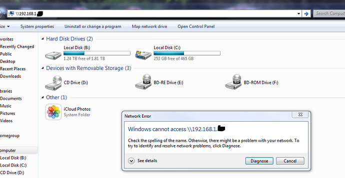

I completed and update, upgrade system and install openhab stable and now I can use the GUI however I cannot access the config files when entering in the IP to map the drive as per below…
In openhabian, did you setup network sharing? Like via samba? You should be able to configure this via the openhabian menu when you access the pi via putty. After that you should be able to map the network drive in windows.
When I tried to re-start from scratch I placed the SD care in an SD reader in my PC and re-formated via right-click and reformat.
When searching I found that someone had used a sandsisk reformat program. Once I re-formated this way and re-installed everything seemed to work as it should.
It may also be that I left the pi alone for more than 45 min as per the instructions as well
