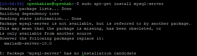

I was looking to clean up some the mistakes I have invariably made since I bought my Rpi3 and started on Openhab. Basically I was a NOOB with both Linux and OpenHab at the time. I’m a little better now thanks to the community. Anyway I followed the steps you recommended. I was backing up a Openhab 2.5 installation with some 40 zwave nodes, 4 IP cameras and MySQL persistence. I have three problems that I am working through. First, and already solved, the Zwave needed the feature:install openhab-transport-serial command to get working. (I had the Aeotec stick on a 2.0 USB hub, as recommended elsewhere as a workaround to the issue it has with Rpi4). Second, I needed to reinstall the MySQL server and ffmpeg as they were not included in the --full backup. This could have been because of the locations I had put them in, so some people may not have these problem using the --full backup. Lastly it seems some file permissions in the fresh Openhabian 1.5 have changed from what I had, so I am having some stumbles to get the persistence and cameras working. Don’t get me wrong, I did not want to do the card swap anyway (wanted a cleaner install), but either because I had a non-compliant, but working instance, the transition did not go as smooth as I hoped (in my dreams).

  1. I did have a significant diversion on the MySQL set-up, triggered by this message.
    I went ahead and installed MariaDB and followed the rest of the steps in the Tutorial, but was under the impression that this required me to use the JDBC-Maria persistence and make the necessary changes. WRONG. Basically if you had been using MySQL, keep the MySQL.cfg and MySQL.persist. No extra driver is required in the addons either. Anyway persistence is working in the Rpi4 as it was in the Rpi3.
